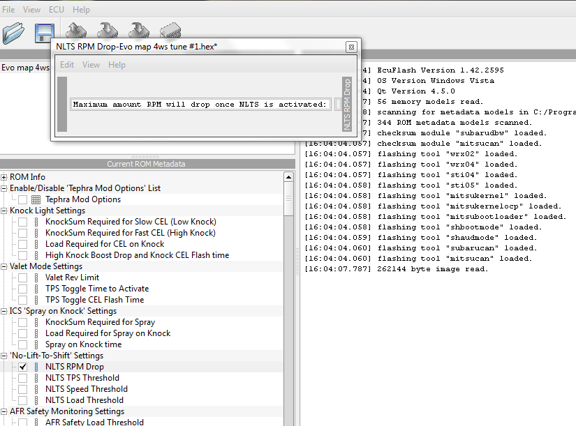

Hello! I am trying to set up NLTS and in the box for RPM drop there is no way to change anything. I have included a screen shot of what Im talking about. NLTS is enabled btw...

Can you try to open the box wider? Looks like you just have a different screen resolution then what is native for ECUFlash.

Box wont open wider and I cant even select any options to manually enter a value. Thats why Im stumped...

Edit your Tephramod xml to make the NLTS description a lot shorter, then open EcuFlash back up and see if that fixes it.

I assume that you're running Tephramod 96530709 so -
- Go to EcuFlash\rommetadata\mitsubishi\evo
- Edit the 96530709 xml in something like notepad
- Find the text that matches the description you showed in the image in your original post
- Delete/shorten replace the description and resave the file (only edit the description and not the whole line of code)
- Restart Ecuflash, open your rom and have a look at the NLTS RPM drop feature again

Ok I tried to get that to work and still nothing. I dont think its a sizing issue since there are several other menus with longer descripitions that still show everything. Any of the gurus care to chime in? Really want this working for this weekend.

Looks to me like the coding is wrong. I have added patches to my rom and have had this sort of thing happen to me. Found my mistake and fixed it. Problem fixed

The info for that table in thats ROMs xml is incorrect/has an error.

Delete the tephra XML's in the evo folder, then download and install the tephra mega pack on the v7 thread.

like stated before the code is wrong in your xml for the rom your using. it should say some thing like row blah blah blah and column... the column part is what is messed up i bet. i had this happen where i accidentally deleted something in my xml where the column part was and it looked exactly like your problem.
