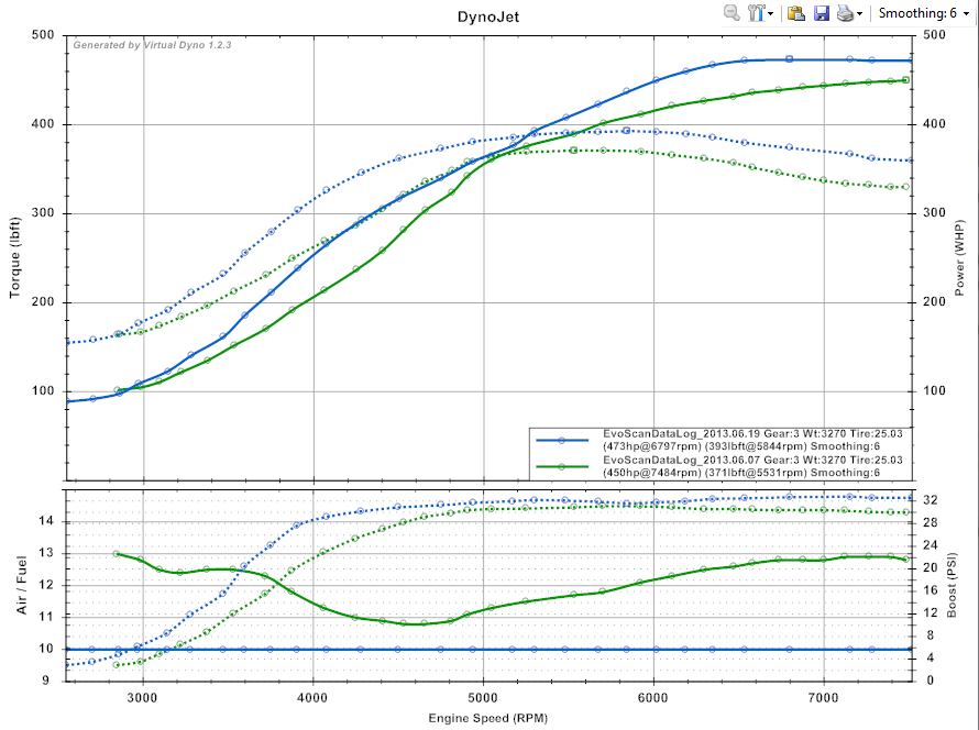

Ready for a shocker? Here's tonight's run with 3 half-turns of preload vs the previous dyno I posted up with zero preload.
Attachment 333919
It made 8-9 psi more at 3900 RPM (19 psi at 3900 RPM with zero preload, 28 psi at 3900 RPM with 3 half turns)
So who still thinks the EF2.5 spools lazily? Look at that difference in torque/spool...
Zero preload @ 4078 RPM = 266 wtq
3 half turns of preload @ 4078 RPM = 326 wtq
I will test 4-6 half turns of preload and see if I can get it to spool even faster (within safety margins, of course.) But these results are even better than I expected considering 3 half turns is very light preload!

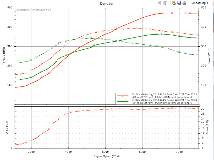

Also, just for ****s and giggles, here is my EF2.5 as of right now vs. my Evo 8 10.5 stock turbo via Virtual Dyno, done on the same road, same time of night:

32 psi at 7500 rpm??? It's pretty amazing that the turbo can do it, and I'd say that this is already a kill mode tune at least at peak rpm. Its impressive that the turbo picked up power going from 30 to 32 psi at 7500 rpm. Will be interesting to see how more whp at peak power can be had. AFRs are a bit on the scary side at peak power, and pulling them down to mid-11s would probably net about 10 whp. If timing is not optimized, there might be another 10-15 whp there as well. Overall, the peak power potential looks to be perhaps a bit more than a BBK Full.
I am having trouble getting the car to flow enough fuel at high RPM... modded Walbro 255. I am going to replace the fuel filter tonight, and if that doesn't work, I will drop in a fresh Walbro 255. I am really on the fence about either throwing in a Walbro 450 or getting a double pumper... I know this thing can easily do 500+ with the right fuel setup.
Also, the timing is NOT optimized for that boost level as far as I know. Tom didn't really push it at all because of the fueling issues so the timing is set rather conservatively AFAIK.
