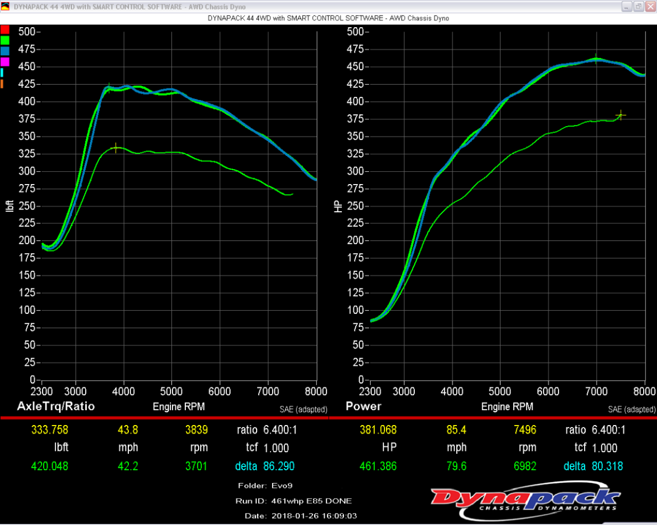

460 hp is on E85.
460/420 is on E85.

I think I saw 435 ft-lbs of torque. Sam tuned it down to 420 since bottom end is stock. He tuned mivec to spool me up early. Look at how early my torque peaks (yikes!!).
Mivec tune with S2 got me about 20 whp from about 3600rpm and 35 whp at 7500rpm. I had Sam give me some cushion by pulling 1 to 2 degrees of timing throughout. Also, my RC 1200 cc injectors maxed out (1200cc rating is at 55psi but my stock FPR runs at 43psi, so it's closer to 1000cc, according to Sam). Pretty amazing still.

Here's a better graph
