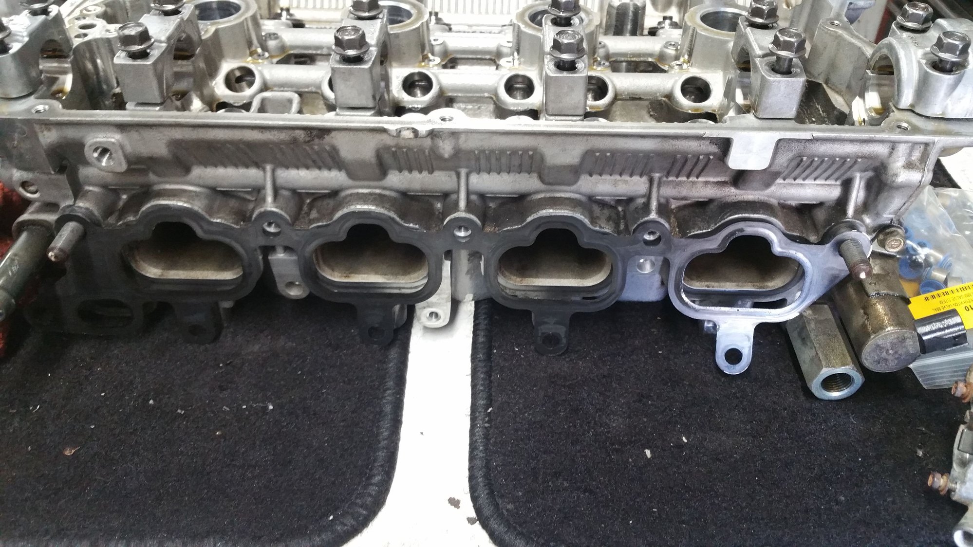

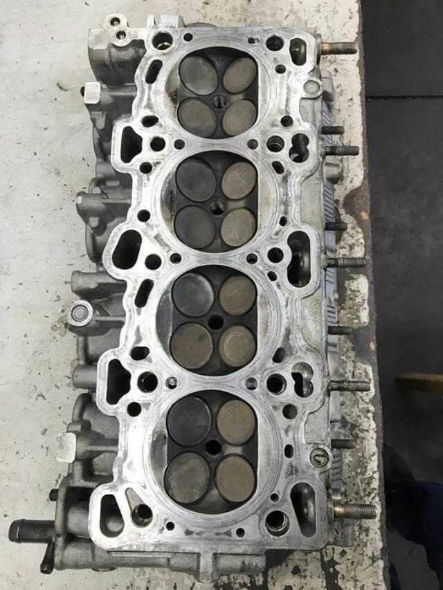

My car took a detour. Started to sound like a WRX. Couldn't figure it out until tuner suggested looking at spark plugs. Noticed black carbon streak (probably from rewired pumo running too rich). Then decided to do compression test. Got 115, 120, 90, 115. Went bavk to do Leak Down Test because I'm not convinced it is piston rings since it still ran strong. Turned out to be leaking intake valve (passenger side of cylinder 3). I can see the light!!!

More pictures of my leaky head...
