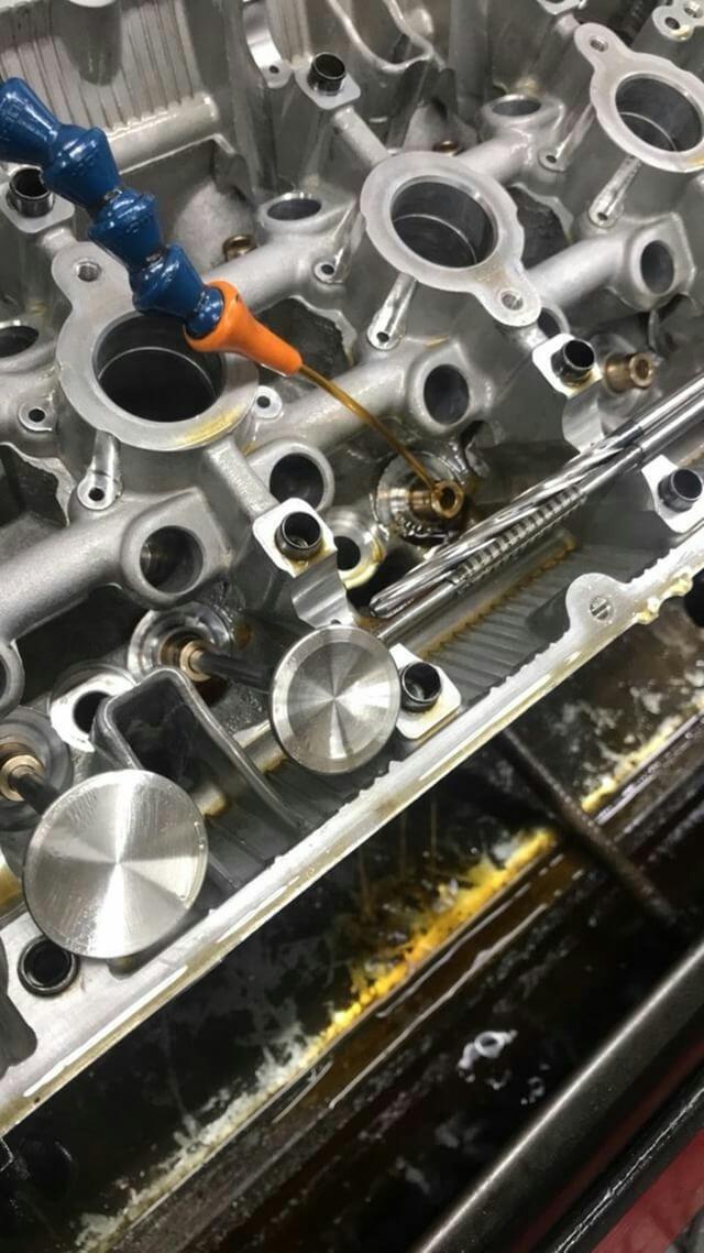

Finally, they're working on my head now.
Old Apr 6, 2018 | 09:10 AM
  #212
Donald. I called your machine shop just to let them know, they have valves in upside down. They agreed & will install them the correct way
Good to see the work being done. Good results are on the way

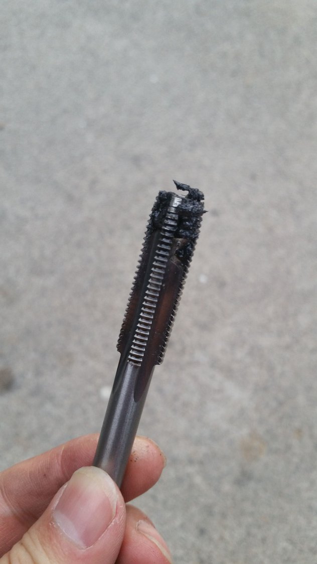

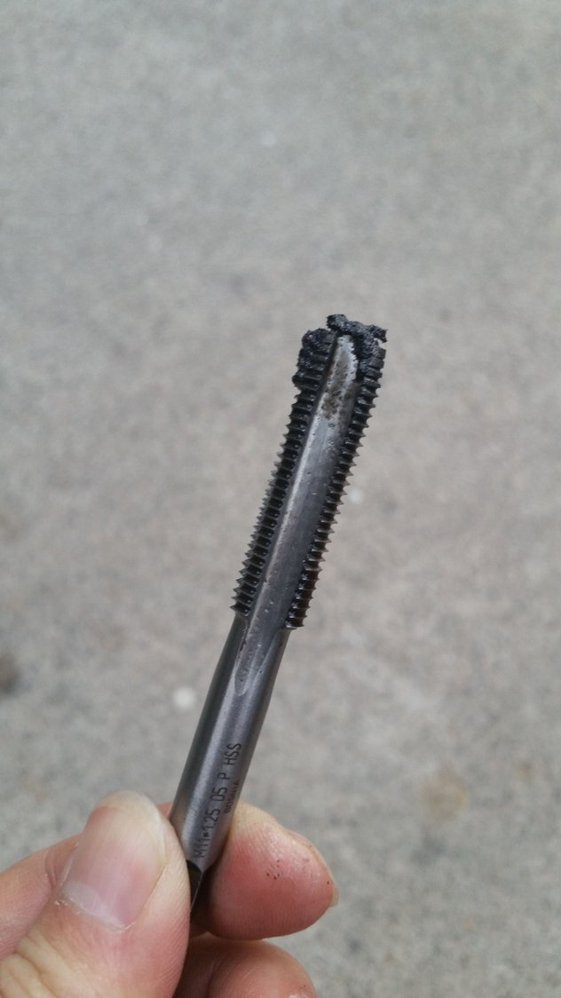

After reading Ron's (Pal215) thread, I decided to do a little more on my car. I chased the head bolt threads all the way down each hole. The worst was the one closest to driver (see photos below). What the heck is in the ARP lube? It felt gritty and it was on the bolt in my oil port to head.
Anyway, I cleaned them all out. Not sure if I want to use that moly lube when I reinstall my head.
