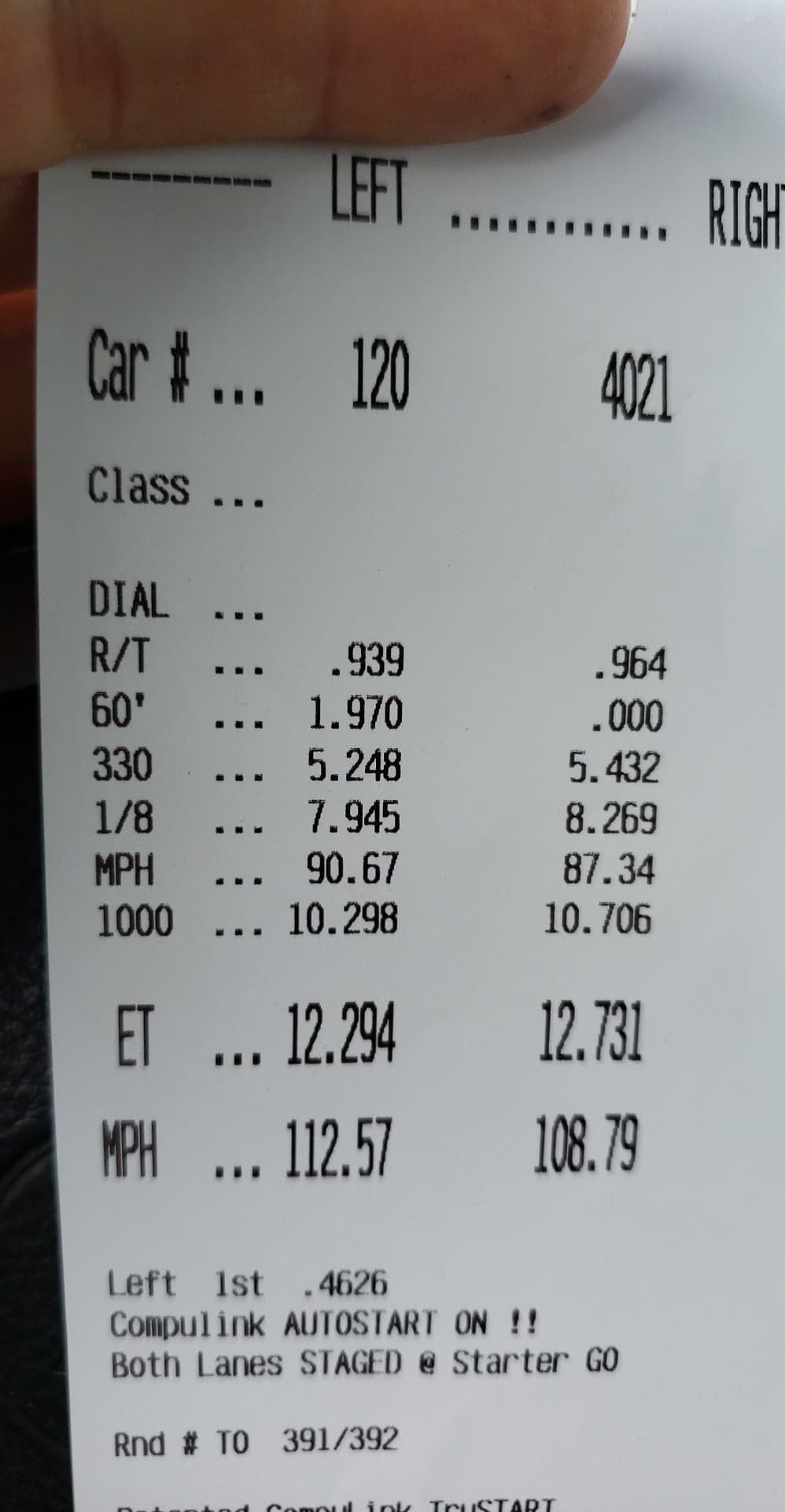

Nice run there Don / Sean
What were the times & top speed?
Old Oct 2, 2019 | 09:29 PM
  #549
2006EvoIXer's Avatar
Joined: Jul 2012
Posts: 3,294
Likes: 197
From: California

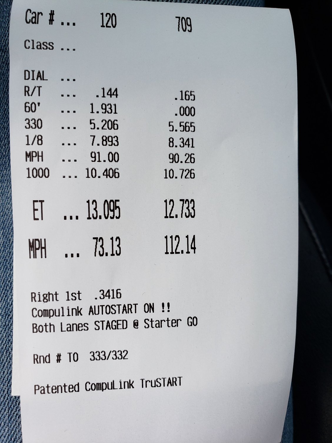

This is me racing Camaro SS. I saw a line and started braking. And found out that was the 1/8 mark, not the 1/4. Lol
