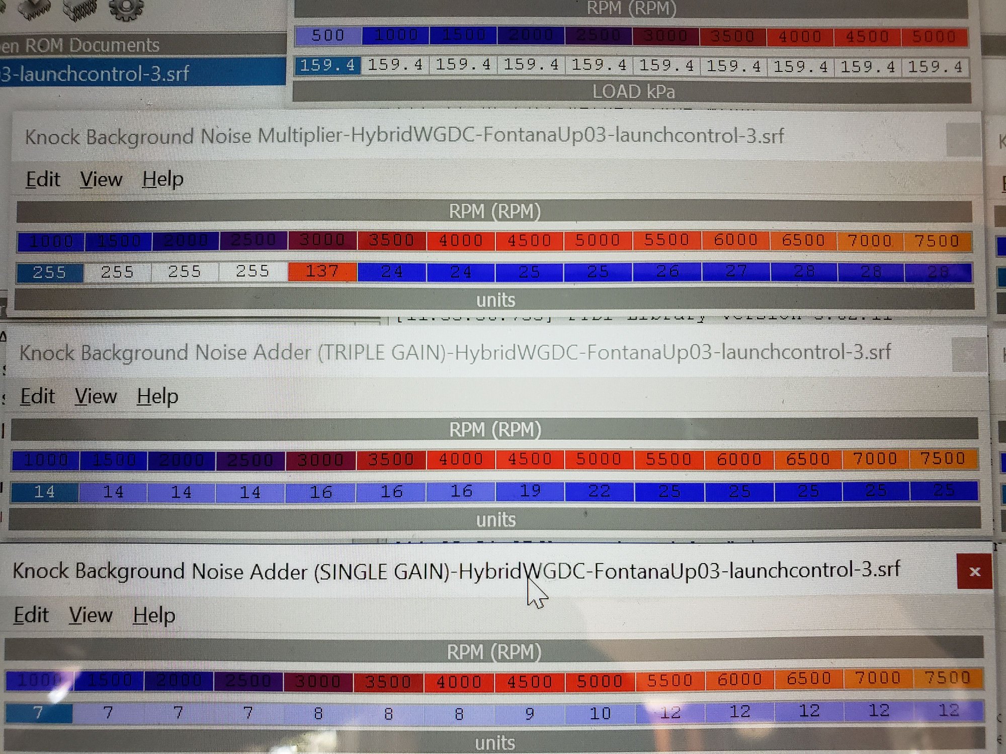

Old Oct 4, 2019 | 11:41 AM
  #562
2006EvoIXer's Avatar
Joined: Jul 2012
Posts: 3,294
Likes: 197
From: California
Originally Posted by razorlab
Did you check your knock filters yet? Getting zero knock sum noise is very odd.
Forgot to check. This is original tune:
Old Oct 4, 2019 | 11:43 AM

Old Oct 6, 2019 | 06:51 AM
  #567
RazorLab's Avatar
Posts: 14,094
Likes: 1,093
From: Mid-Hudson, NY
Those knock tables are increased an **** ton! Tripled in some cases. No wonder you don't see knock now and before.
OEM:
Knock Background Noise multiplier
13 13 13 14 14 17 17 19 19 18 19 20 20 20
Knock Background Adder Triple Gain
7 7 7 7 9 9 9 12 15 21 21 21 21 21
Knock Background Adder Single Gain
2 2 2 2 3 3 3 4 5 7 7 7 7 7
Old Oct 6, 2019 | 01:02 PM
  #568
