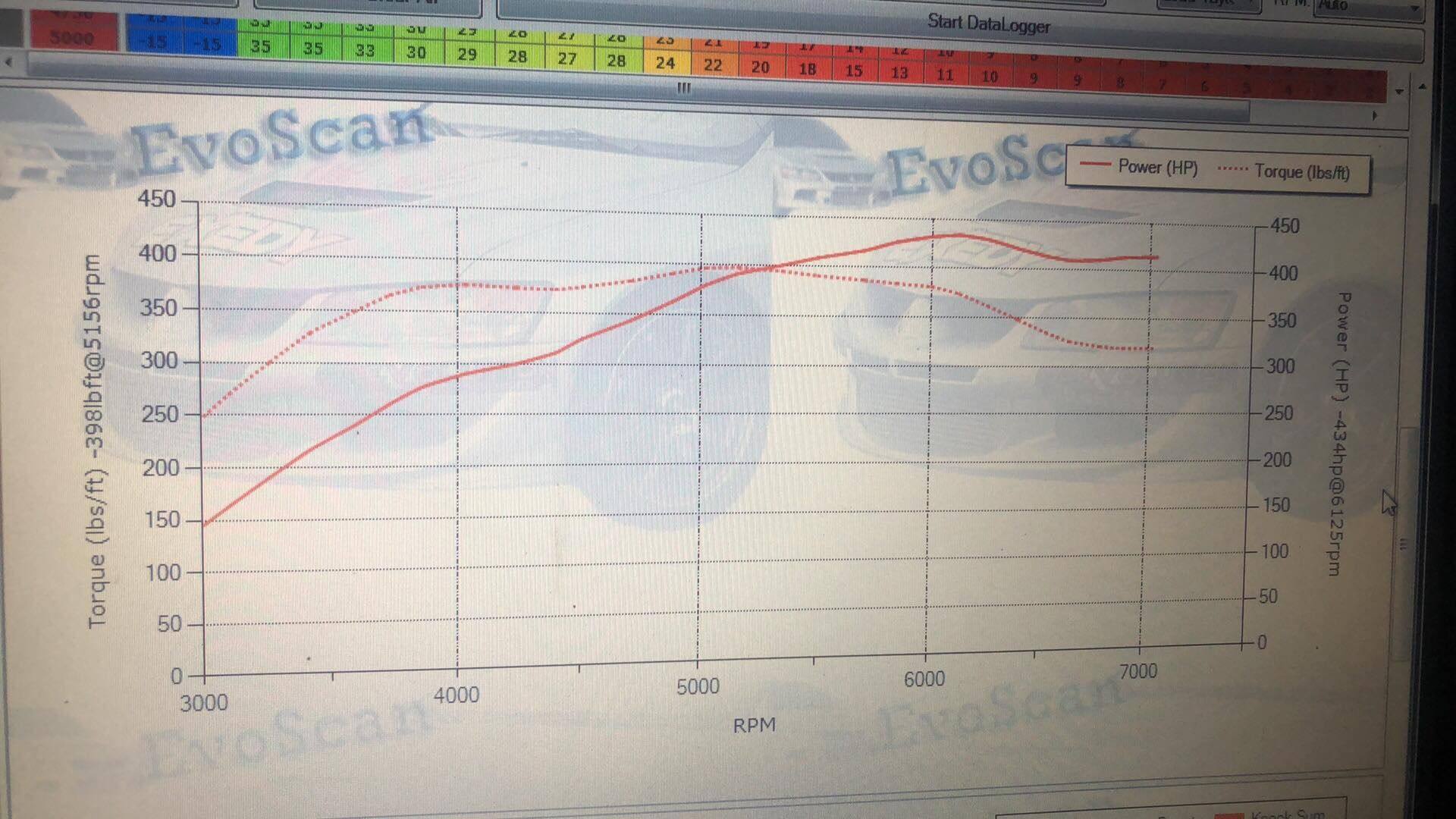

Don, did you run those 34 psi logs thru Virtual Dyno? Wondering what kinda torque you were making there

Originally Posted by Wicked_X
California smog sucks. Always gotta be alert, and pray you dont get state ref'd.
I did with 30psi spoolup, but I don't full trust these numbers so I'm playing it safe until I get on a real dyno. This run was after I fixed the MAF blips from hitting 30psi and getting a choke in MAF readings. My boost gauge shows "---" at same time, so I don't know what the problem is if it's not surge since I don't have a zigzag.
I'll run the logs with the MAF problems later.
Pretty sure Virtual Dyno is more accurate than evoscan, as long as you have your weight accurate and a flat road. I always got weird numbers with evoscan, but may have been using it wrong
