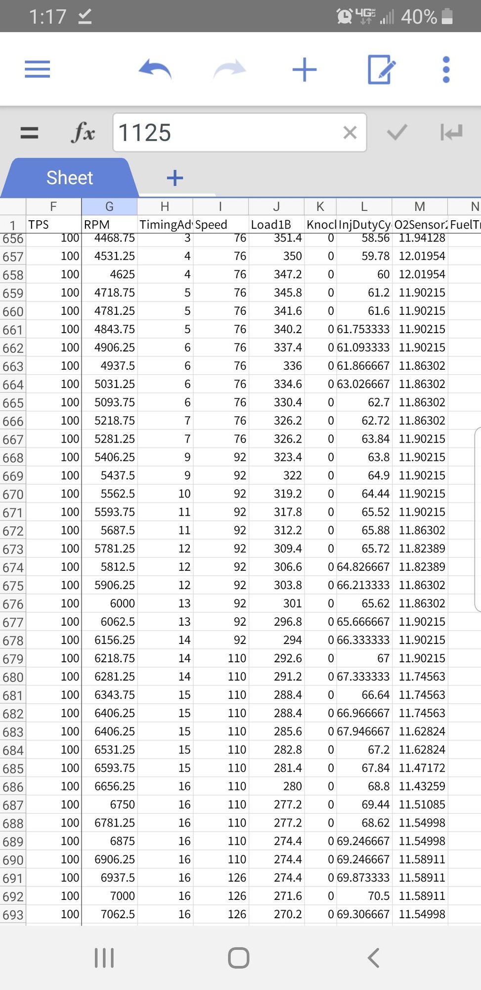

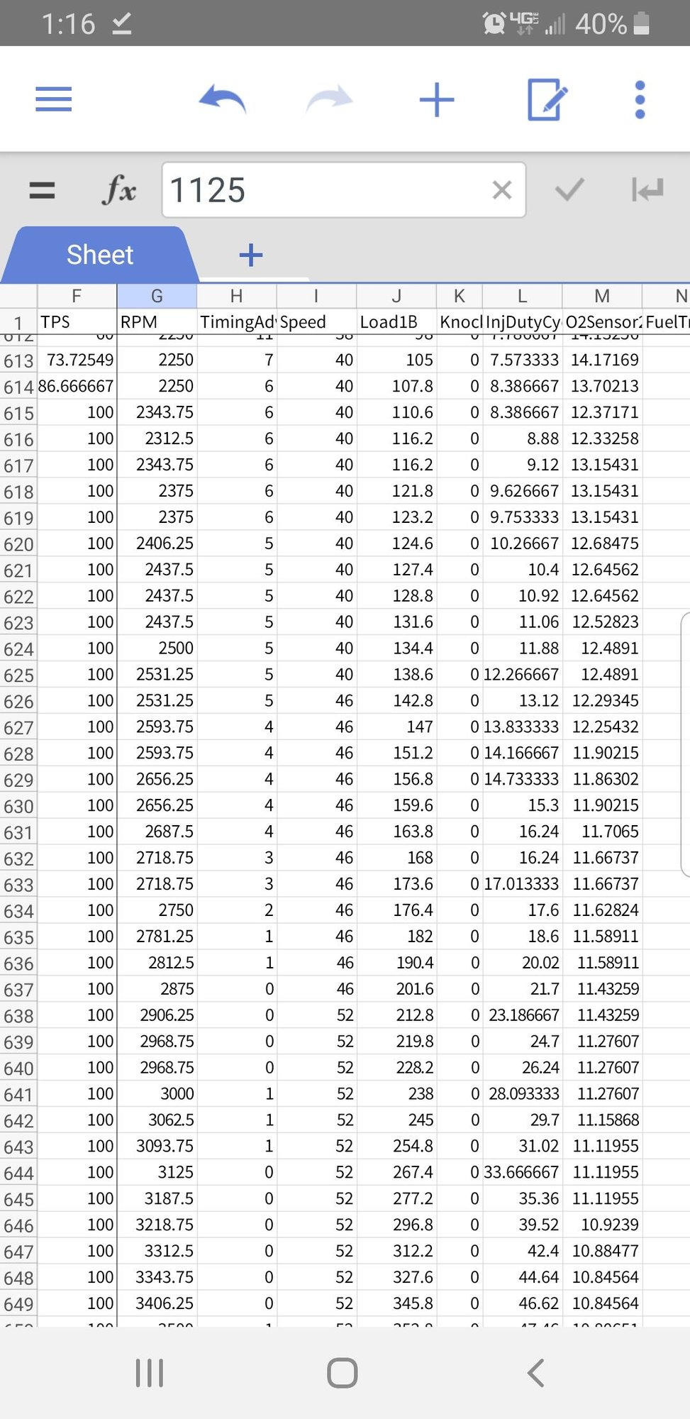

Also, turns out, AFRs were in 10s on spool up and leans out to 12.7 up top. Now, car runs 11.5-11.8 with dips into 10.8 at spool up where max wtq was (3100-3800). Last night, my 71hta now spikes to 35psi and settles down to normal. So my revised tune lets turbo spike higher and run no timing until turbo settles down. And timing is about 5° less throughout (and more at spool up range). My tires no longer breaks loose in 1st gear at spool up, but it still hauls. It was fun going sideways when turbo hit, but this is more sane. Haha.

You have something going on where you are going rich then lean and then ok (I don't mean too rich/lean just assuming a 11.5 target). I would try and smooth that out a bit. This might not be a tuning thing, but you should be able to see whats going on from the fuel map. If the map is pretty smooth in those areas then that would make me lean more mechanical. Then I would probably take all those 0 timing cells and make them 1 so you don't get 0101 oscillation going on.
Your timing is very conservative in the 3k range. You can probably add more back and compare Virtual dyno charts. If it picks up torque add more and repeat. If it doesn't get more (or very little) torque or it loses then subtract 1 and call it.

I think timing down low looks ok. The curve really looks decent but I would like to see boost, not just load. Depending on boost, it may be happier with not getting 5* until 5k, and then slowing the ramp to 10* out to 6k, then 15* at 7, and if you revved it 8k, you could give it another 1-2 degrees from 7-8.
Also, why aren't you revving it to 7600 or 8k?
I was doing pulls on freeway onramps. Cars in slow lanes were going 70 and I'm pulling right up to them and hitting brakes. Lol
