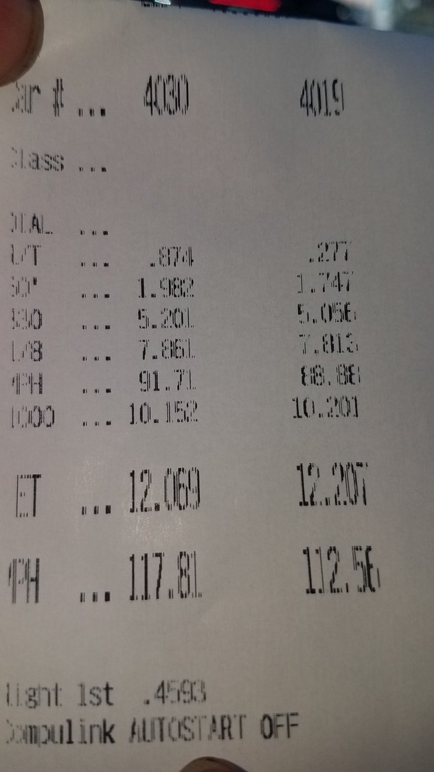

I finally figured out why I'm always having a hard time launching at Fontana!
I finally installed evoscan in my spare laptop since I lost my Surface Pro and logged most of my runs. Turns out, my 2 step started to pick up severe knock when temps got hot on track. So my 2 step started to pull timing right before my launches and I bogged. I had 1 good run in before it got too hot. I'm #4030.:

Don,
what turbo are you running for the latest time sheet?

I'm still running my 71hta. It should be in 11s once the launch map is fixed.

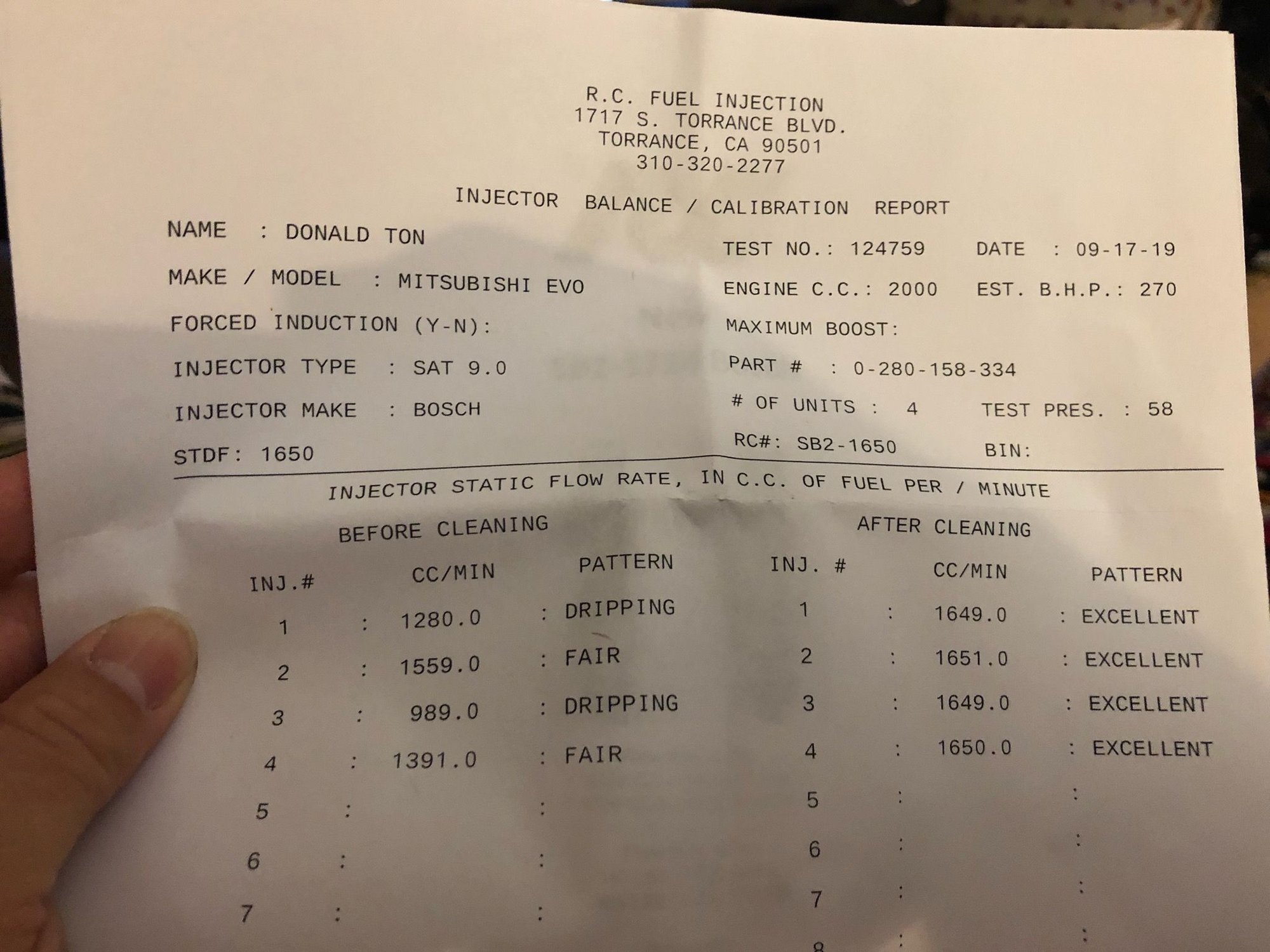

FIC 1650 are actually 1400cc @ 43 psi?
After about 16 months of running E85 from my local station in Stanton (I ran 91 octane gas once or twice to flush out my fuel system), I decided to get them cleaned to be safe. There wasn't any signs of problems as AFRs are always 10.0 to 10.9 at WOT and cruising and idles are always 14.5-14.8. I only had them cleaned because my friend needed his cleaned, so I sent mine in at same time. Injectors had no visible gunk, so they all "looked" good.
And here are the flow results from RC:
I've driven maybe 5,000 miles between cleanings. I'm going to find another station to buy E85 from since my injectors are so badly clogged.
I think the tech that tested my injectors last year setup the pressure wrong because #2 injector flowed 1559cc before cleaning. My guess is it was at 33-35 psi and not 43 last year.

Also, I always try to drive at least 20 miles if I start my engine to make sure there's pkenty of heat to evaporate E85 in my intake and injectors. I am surprised how #3 was under 1000cc with so little use.

Interesting, I had a couple ID1k and ID1.3k injectors that where 98% on E85 for 1 year+, including just sitting not being run for a decent amount of time sent out to be cleaned and they all passed.
I think it's the tanks in my area being redutied to hold E85. I've always suspected I'm getting dirty E85. Now I know.
