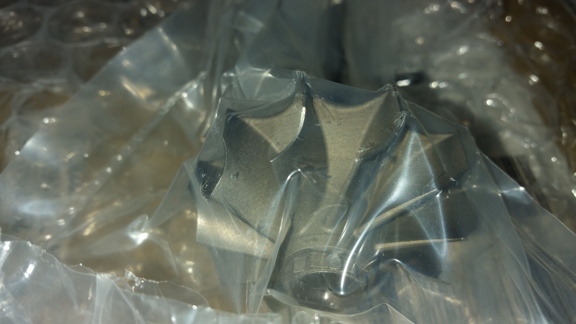

Old Dec 12, 2018 | 08:08 PM
  #420
2006EvoIXer's Avatar
Joined: Jul 2012
Posts: 3,294
Likes: 197
From: California
Originally Posted by 2006EvoIXer
Here is the 11 blade turbine wheel that is the same size as FP Green FP54:
Decided to go with FP54 wheel (9 blade) instead of 11blade.
