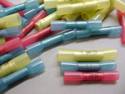

Here's what I was talking about.

ok new problem...whats with splicing the wires...i stripped them with the wire cutters and i have the butt connectors but how do they connect? Do you have to squeeze them somehow with a pair of pliers? Because I also tried this and had no success

Yes. Twist the exposed ends of the wires and stick them into the hole on the butt connector. Crimp the connector about a third of the way up the connector (about halfway up the end of the wire) with the crimpers that have been mentioned above.
