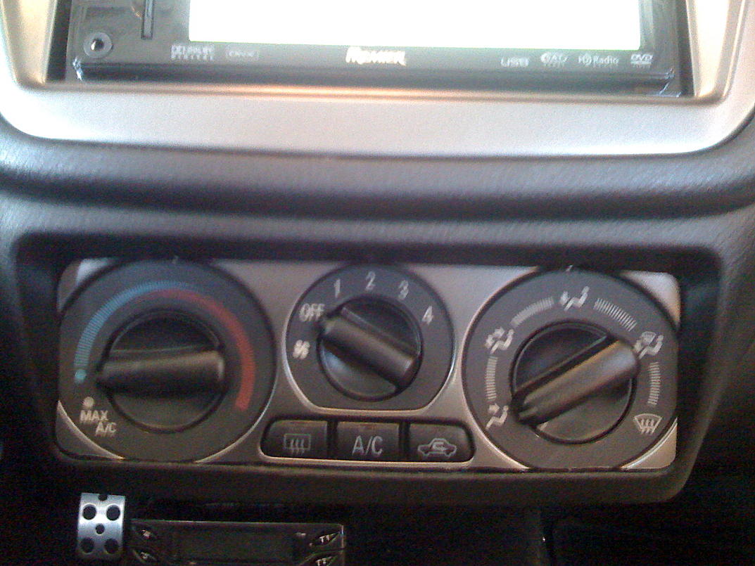

Given the choice again, i would just spend the money to get the oribtal kit or something...
cutting the hvac face plate was the worse... gotta shave off the extra on the side, and cut off excessive plastic in the back .. getting that two hvac line with the clip outta their housing was the *****es,, so hard to take it off, and the left hvac cable need to be re-routed to be long enough..
I positioned my navi's transponder in the dead center of the front window vent, there was a clear route from the middle hole back to the center console, which is very neat ;D
I have the F series too, but i just don't like the spacing around it.. isn't there a kit for us to us to take out the spacing ?
second, I used my stock radio mount, is that wat everyon used ?
I noticed with the JDM radio piece, it is good, but sunlight would get in the way ...
did you guys mounted slightly tilted ?
also, yea , i think i've cut my hvac faceplate the cleanest ;D
thx
yours came out very well, as for using stock brackets. no i couldnt find mind at the time so i made some costum brackets.

I finally got my trim piece installed and it looks a whole lot better than I thought it was going to. The gap is a bit annoying, but only really noticeable on the bottom. However, because of lighting, the bottom gap is harder to see anyway:
Here are the pics of how mine turned out. The HVAC relocation looks little strange because the trim I have is from a regular Lancer, so I painted it with the closest-match plastic spray paint I could find.
thx
I was leary of cutting down the HVAC panel too, but I have an extra one, so that made the decision easier. The belt sander really came in handy for fine-trimming it and keeping edges straight.
Yes, I used the stock mounting brackets - they worked just fine for me - even with having to drill new holes to lower the radio for the trim piece.
That's a good idea about tilting... I didn't try it. I think you'd have to tip it quite a bit to avoid the sun glare and then it would look funny not being even with the trim. Best answer there might be to get one of single-DIN units with motorized screen so you can adjust the angle.

wow. you ddin't get the JDM piece right ? well at least that doesn't look like an JDM piece, but that thing pretty much flush with the navi, hardly any gap at all.. good job !
