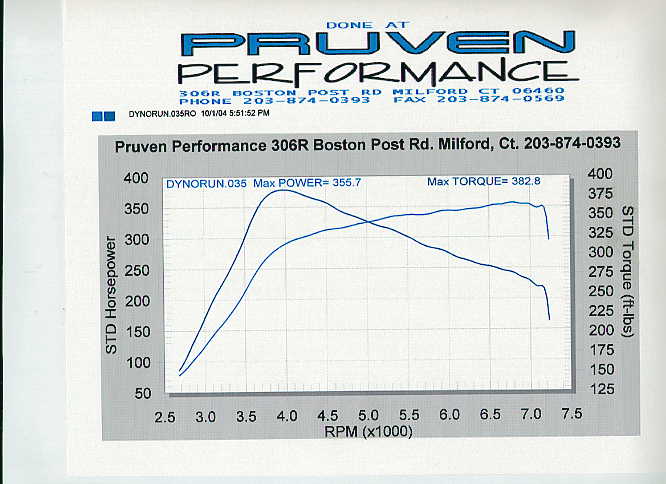

Gentleman - next week we will have a lot more data about the WR turbo as the member who has been my customer for some time who made this dyno sheet is comming in for a retune after just adding his WR turbo. HERE IS HIS STOCK TURBO DYNO SHEET>
Here are his mod list and further data. - https://www.evolutionm.net/forums/sh...ght=Case+study
It will be interesting to tune the WR over this dyno sheet and see how it helps on a car with more mods.
