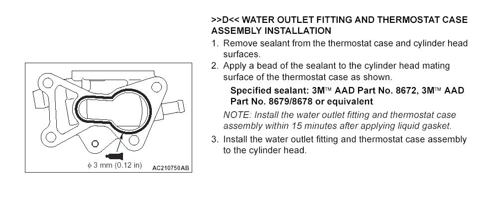

bump I also need to know if the thermostat housing (the area that connects to the cylinder head) is required to use a gasket from mitsu or just a liquid gasket from permatex that you get at pep boys, or both. please someone answer.
Old Oct 21, 2005 | 06:12 PM
Compjoc's Avatar
iTrader: (21)
Posts: 1,018
From: Kansas City
The manual says to use the 3M Mitsu liguid gasket but i guess the permatex would be alright, just give it plenty of time to dry
Old Oct 21, 2005 | 06:18 PM
Compjoc's Avatar
iTrader: (21)
Posts: 1,018
From: Kansas City
Make sure you used the Ultra Grey stuff.
Old Oct 21, 2005 | 06:27 PM
MrMejia's Avatar
Joined: Apr 2005
Posts: 701
From: Oceanside
yes thats exactly what I did, hew: I thought I need to reinstall. Everything seems fine now I guess. But I dont understand why mitsu would just put a crappy gasket in there in the first place. It leaked like a mother.
