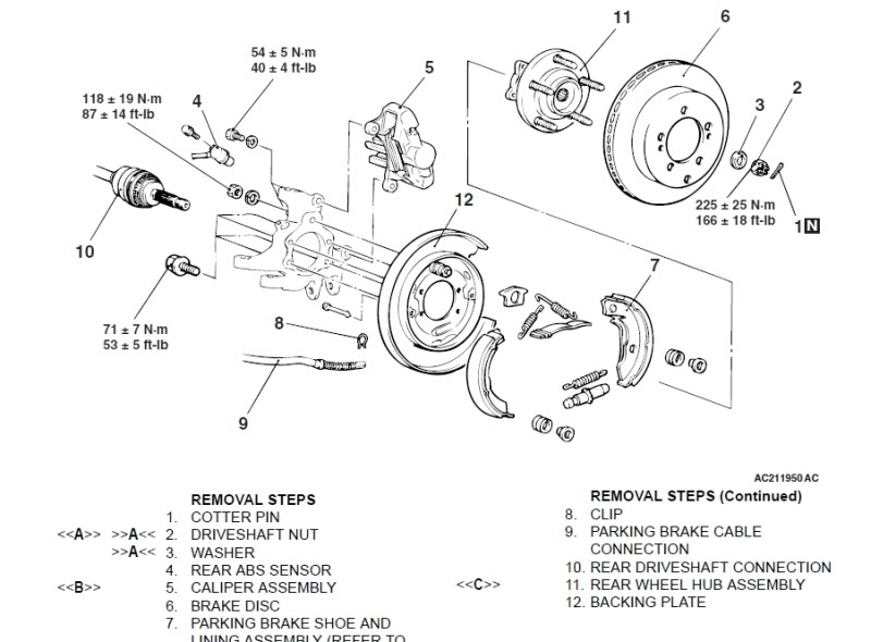

Originally Posted by boostedwrx
Attachment 291726
I can give you the good FSM CD if you need dude.
Do you have a torque diagram for the Evo 8 front suspension similar to the rear one above? Do you know the torque spec for the steering rack inner tie rod?
You can find everything you need here: https://evoscan.com/vehicle-manuals
