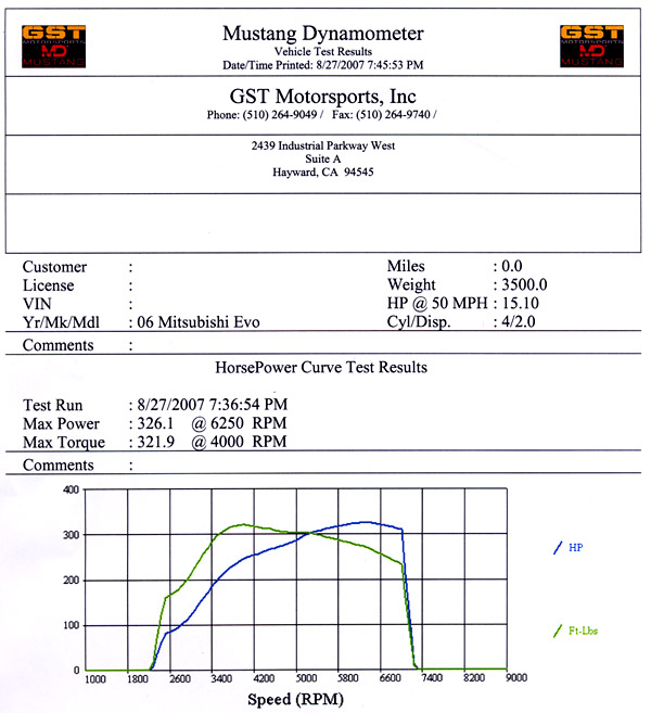

Originally Posted by mplspilot
Here's my conclusion: Exhaust porting and aftermarket O2 housings don't seem to make a difference.
Keep in mind one of those has a HFC and one has TP.
Good porting and a good 02 housing does make the car much more efficient. The 9's seem to love it.
Here is a Evo 9 with stock turbo, ported exhaust mani, Ported hotside, cosworth cams, test pipe, exhaust cam gear, 91 oct, street tune:
Compare that to the FPgreen charts on 91 I posted before. Yes this is a strong 9 but it really woke up with the last round of mods, one of which was all the porting. It holds the 91 octane stock turbo record on our dyno.

Those numbers are crazy for stock 9 turbo on 91 pisstane. I have all bolton's and cams on my 8 and can't crack 300 on mustang dyno. I just purchased a 9 turbo and am sending my exhaust mani/02 housing out to be ported. Hopefully will turn the 9 into the Green this winter along with ported intake manifold/TB.

288 on CBRDs dyno ain't bad for a 8. I believe his dyno reads pretty close to ours, although he has the advantage of higher octane then we do.
Most TBE bolt on 9's do about 290-305whp on our dyno
Most TBE 8's, cams, etc do 275-290 on our dyno. Some do 300.
100% bone stock 9's do about 230-240whp
100% bone stock 05 8's do about 215-225whp
100% bone stock 03-04 8's do about 195-215whp

I was about to say those numbers aren't very impressive until I noticed it was on a Mustang dyno.
