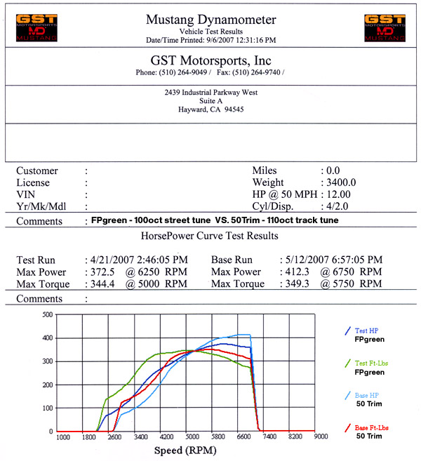

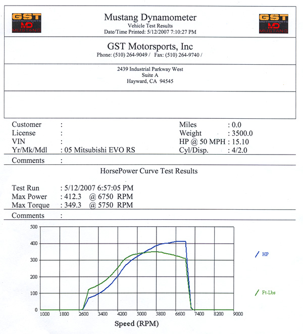

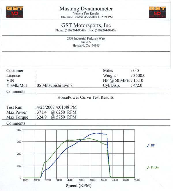

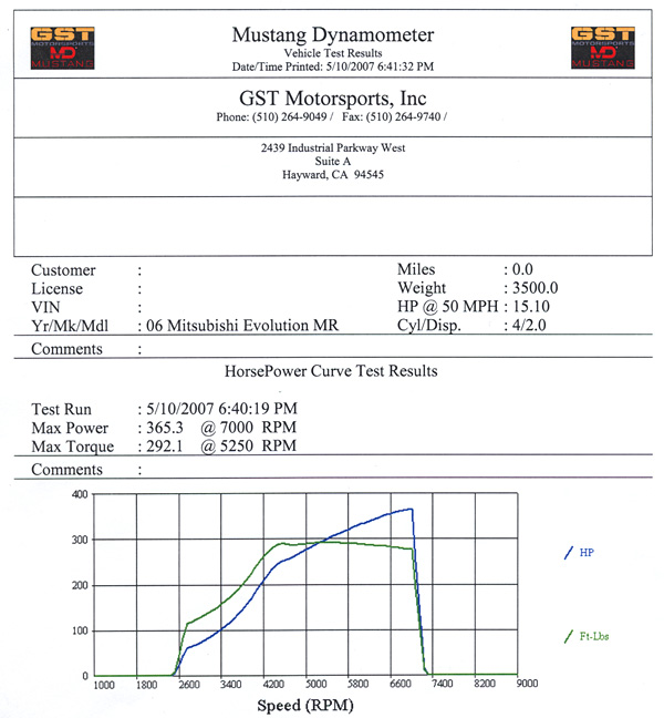

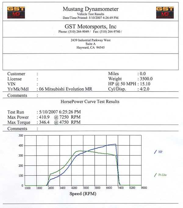

Everyone likes data so here are a bunch of FPgreen and 50trims from our mustang dyno in various states of tune and octane:
FP green, Evo 8, Cams, stock unported exhaust manifold and 02 housing, 26psi (ecu-controlled boost) 100oct aggressive street tune:
Same Evo as above, 24psi (ecu-controlled boost), 100oct semi-conservative street tune:
BB 50trim, Turbonetics cast manifold, Evo8, Cams, 24.5 psi (MBC) 110oct open track conservative tune:
FPgreen evo from above VS. BB 50trim Evo above. Of course this is not apples to oranges because of the different state of tunes and octane but it's a good overlay to show response differences:
AMS 50trim kit, Evo9, Cosworth cams, 22psi, 91 oct street tune:
AMS 50trim kit, Evo9, Cosworth cams, 25psi, 91 oct + meth street tune:

Thanks for the graphs. Obviously shows the Green shines prior to 5K RPM's and 50 trim has the edge past that point. Preverance on the owner.
I would rather spend $1000 to upgrade my 9 turbo than $3500 for a 50trim. But with the 50Trim kit, you have the opportunity to upgrade to a larger size turbo later down the line (depending on the manufacturer).
