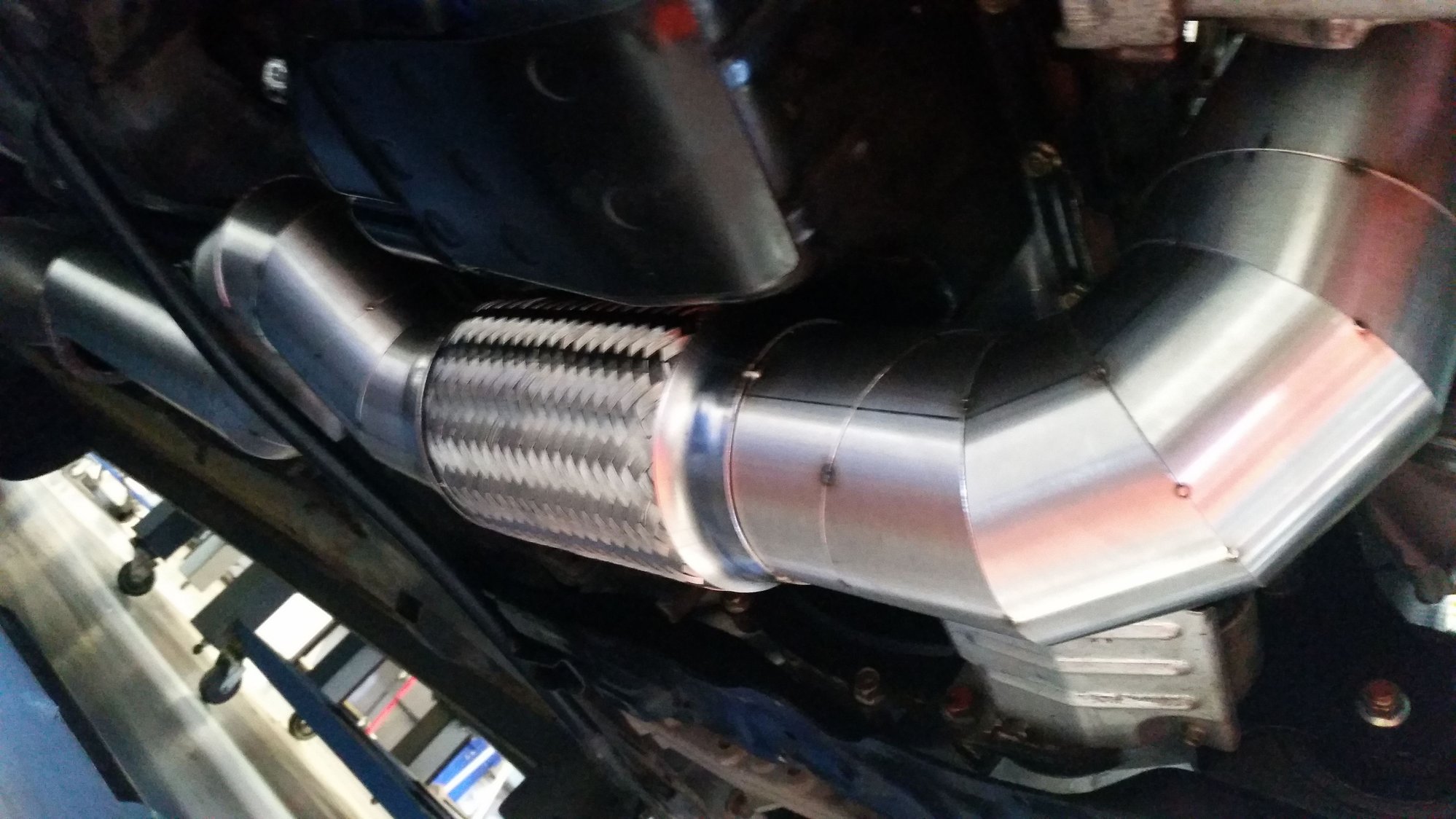

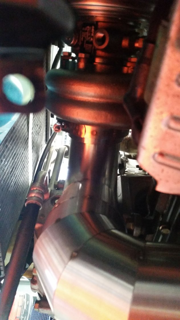

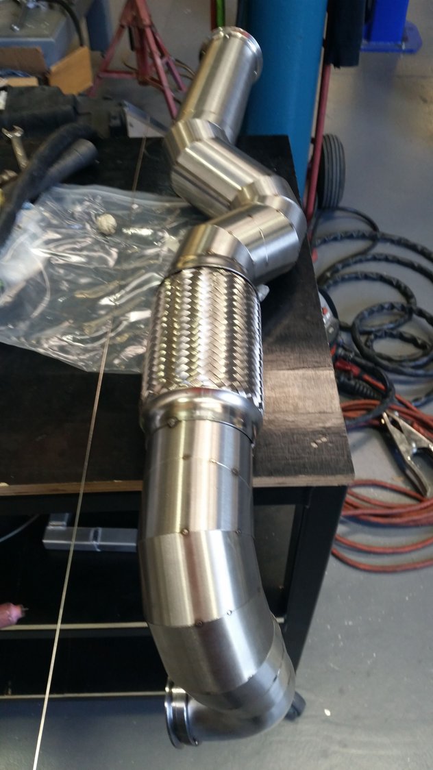

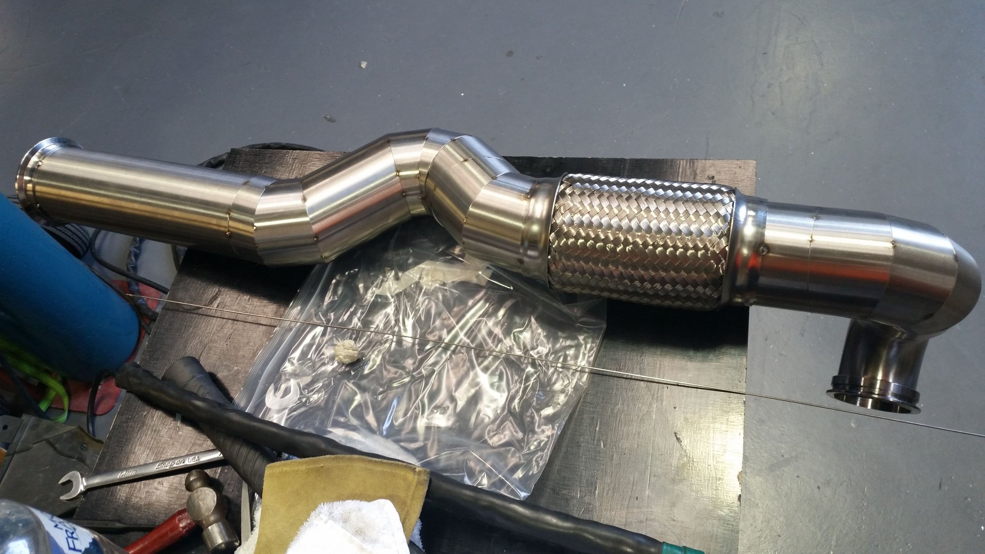

3.5" dump pipe tacked up today.

Is that what I think it is? A 3.5 DP with AC?
I wonder if there is a of the shelf manifold I can buy not just for BW but a standard t3 or t4 TS which moves the turbo over to the driver side to allow for more clearance to run a 3.5 DP with AC.
Fitment is a real challenge with the EFRs. They are much longer than other turbos, especially the EFR IWG versions. Its unlikely that there are any off-the-shelf universal T4 manifolds for the Evo 8/9 that allow any of the EFR turbos to "drop-in". They are too long, and the B2 frame EFRs are also very large in diameter.
