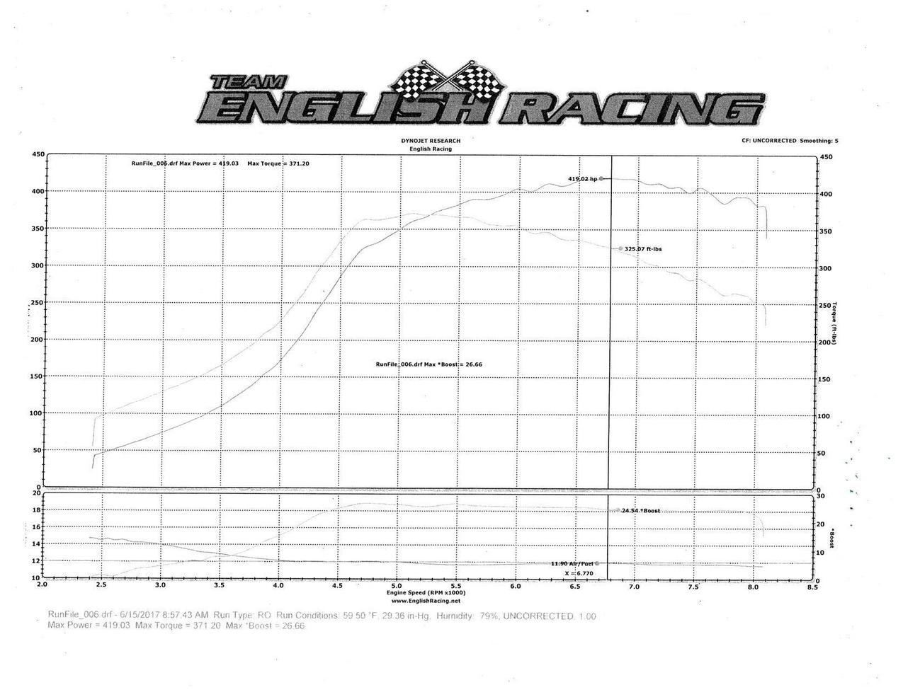

Here's my recent setup on a stock block on 92 oct:
7670 EWG 1.05 ar
ETS twin scroll kit
ETS 3" intercooler
Walbro 255
FIC 1100
GSC S1
Stock intake manifold and throttle body
Thanks to the guys at English Racing and ETS!

Surprised by 7670 moderate power and somewhat laggy spool
This power is in line with HKS7460, BBK-Full, and FP Green.
I would have expected full spool by 4000-4100rpm, and 450whp, at 25psi on top.

I was expecting 450 whp as well but I'm anticipating a built block in the near future. For now I'm happy with how it feels on the road.

I have to disagree with Nemsin, 7670 not working well on 2.0:
I personally enjoyed an E9 with basic built block (people have pushed stock blocks just as hard and harder, so this was nothing un-attainable to the OP)
The car was built recently by Speedelement in San Jose,
E9 2.0 with Full Race EFR7670 1.05 AR
Trick is it was on E85.
Oh my GOD, this was simply stupid, stupid responsive, and stupid fast.
I have fast cars, so am not Prius driver never driven anything like Evo.
Full boost by 3600rpm, tuned to 26psi on Dynojet, it was pushing low 500's.
I have to check the dyno sheets/data I have somewhere.
It eventually made 600whp circa at 34psi..on 2.0 on E85 street tune.
But at 26psi at making low 500's it was absolute mad crazy car already.
On 92 pump 450whp...it should be plenty rapid, and hopefully full boost by 3700-3800rpm.
