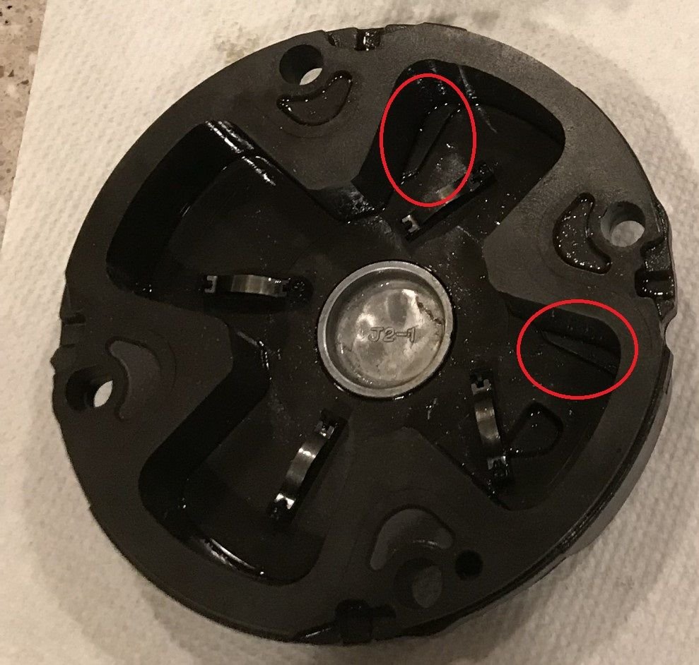

The new ACT 6 Puck Sprung disk was installed today and I got the tranny and transfer case installed as well. Prior to putting on the sub frame I decided pull the front timing cover to make sure there were no small leaks and everything looked great. I also decided to remove the MIVEC gear because I want to do the English Racing modification so I can get more intake cam timing. In stock form you should be able to run ~28deg, but I don't see more than 26deg despite targeting 28. On the GTR I run 32-34 deg so I want to see if running more intake cam timing will get the turbo up quicker.
Getting the bolts out was not an easy job and I ended up having to weld a bolt to one of the torx bolts to get it out. I'll just have to get some new bolts from Lowe's tomorrow.
I'll probably stick with 6-7deg additional over what I have and see what happens. Should have it done and back together tomorrow.

That link is the one I used as the basis for the modification. My only comment would be that you need to make sure you don't grind off too much material from the stop tab. If you do the MIVEC will be stopped by the small lip on the cover of the MIVEC, which may cause damage to the cover and send crap through your motor. If you look at the picture below I have circled the small lip in red that also limits the MIVEC travel. If you machined those small lips with an end mill and completely removed the stop tab it allows for another ~10deg of rotation according to ER.
