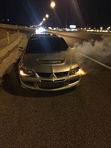

Haven't posted this here yet. Happened end of February. Still collecting parts.

I can't make out what broke in pictures. Is this a stock bottom end?

Yeah. Sent rod #2 out.

Were there any indications or signs before rod quit? Maybe rod knock or taps?

Nope, was getting on the freeway at WOT, shifted 3-4, went a little more, just let go. She had a rough life. Not really upset about it lol

My rod bearing didn't spin. I'm pretty sure I can still see the big end of the rod attached to crank. Rod beam simply failed. Was cold night, boost was probably up, making more torque than what we tuned for, and she said no mas.
