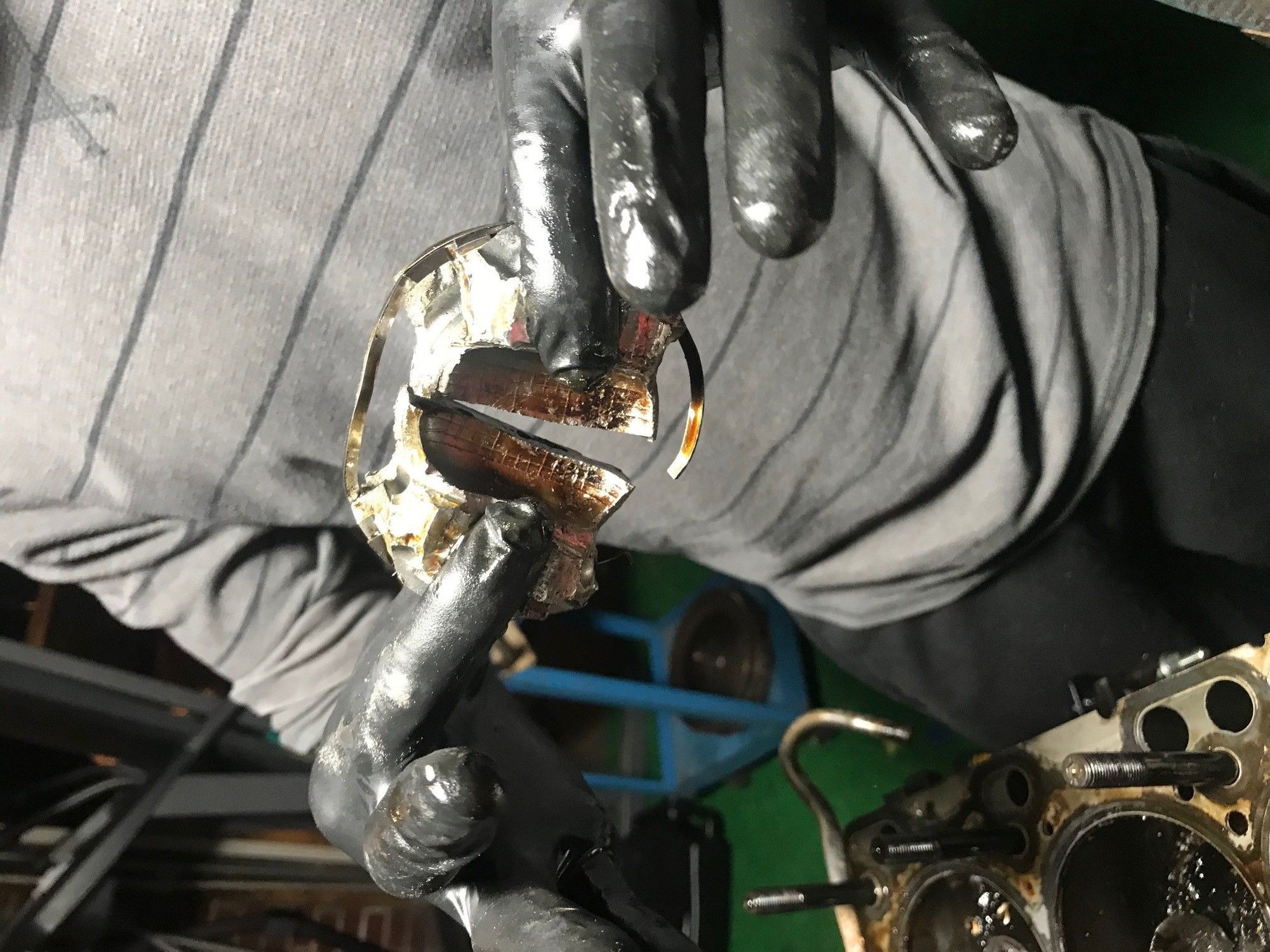

Finally got around to tearing the motor apart. Looks like Cylinder one completely shattered and is in the oil pan. Cylinder 2 looks to be melted/shattered. Head is completely destroyed

Dang! Looks like the piston ring was the only thing left holding that piston together. What the heck! There are so many sinister and creative ways that these engines fail.
yep, only the ring was holding that piston together

Originally Posted by RightSaid fred
That looks like an extreme example of broken ringlands.
Surely a catch can would fix it?
Plus making the vents all bigger..........it always works.
It even stops the dipstick from blowing out.
Check the sparkplugs.........there's oil on the threads.
Tells you you've broken the ringlands.
Didn't have any spark plugs left . I just got my hands on a STM 3port VTA OCC just incase

Originally Posted by ExViTermini
Wow, talk about a meltdown....
Looks like 3 different failure modes all in one engine lol.
Just ongoing and excessive detonation.
Once they get a bit of blowby, the oil reduces the octane rating and it detonates more and more and more.
If you've got an aftermarket ECU, the knock detection won't work.
