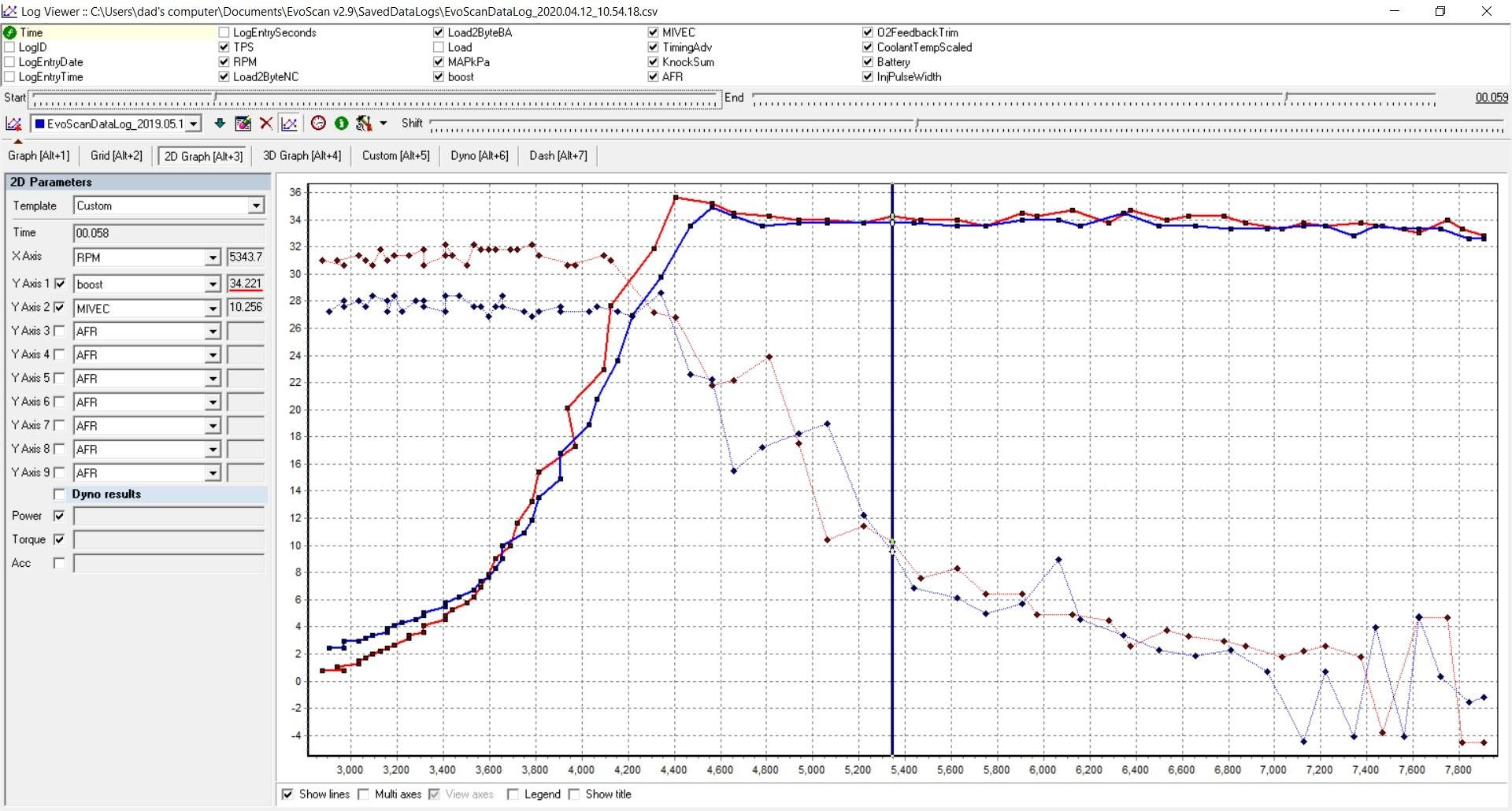

Post 214 above shows back to back runs using the new MIVEC values during spool with the only difference being I ran negative cam timing above 7000 RPM.
Below is the requested street runs before and after MIVEC changes during spool.
Thank you

As promised, logs of the spool up in 1-4, and also a 1-4 rip to show transient response. It honestly feels identical to the MHI FP red when it was on my stock engine (non-mivec 2.0, S2's). This car is a non-mivec 2.2 with S2's.
First one has the 1st, 2nd, ad 3rd gear log files, 2nd one has 4th gear and the 1-4.
https://datazap.me/u/letsgetthisdone...2-3&hg=1-1-2-3
https://datazap.me/u/letsgetthisdone...3-4&hg=1-2-3-4

Yea I reviewed the logs and the turbo does spool up fast. I believe the data shows that the transient response from vacuum to full boost is averaging a little under a second between most shifts.

I was gathering .3-.4 second boost recovery.

So your 20psi boost threshold in each gear is around:
1st - 5350rpm
2nd - 4550rpm
3rd - 4100rpm
4th - 3850rpm
For comparison - mine with the TD06-20G sized turbo and twin scroll (which will make much less power than yours) is:
1st - 5500rpm
2nd - 4000rpm
3rd - 3200rpm
4th - 2850rpm
(for same 20psi boost level)

Where is makes 20psi really doesn't matter. Where it makes 300ftlbs on a dyno is whats important. So not having a dyno sheet to see what torqwue # that 20psi correlates to, the data becomes vague.
