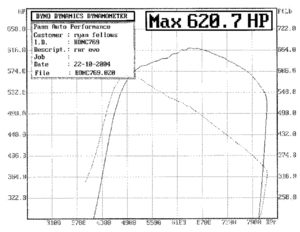

Ryan sent me the dyno sheet:

Great job Ryan. I saw the car run at nhra couldnt find you after the run though.
