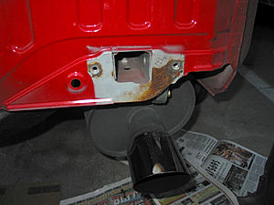

Mark another for me. I'm thinking all Evo's have this. Has anyone who has taken your bumper off, not find any rust?

having problems attaching pics, but here it is

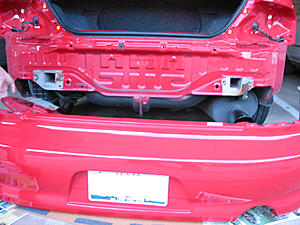

Old Sep 25, 2003 | 07:20 PM
  #110
Thoe99's Avatar
iTrader: (25)
Posts: 2,202
Likes: 20
From: Orlando, FL
another

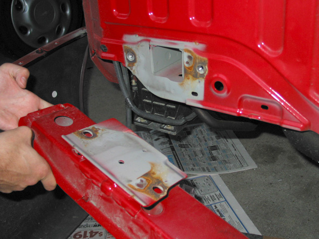

Old Sep 25, 2003 | 07:21 PM
  #111
Thoe99's Avatar
iTrader: (25)
Posts: 2,202
Likes: 20
From: Orlando, FL
right side:

freedom's Avatar
Posts: 755
I would think that it is a good idea to shoot rust proofing up into the rails as they appear to have the same surface treatment as the area under the bumper beam. The Mitsubishi recommended rust proofing is a wax based product.
