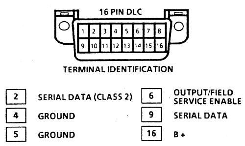

I'm not sure if obd2 is observed by law in Guam.
Make sure the pin fitment is secure. Look for bent or corroded pins in the obd2 dlc.
Make sure both grounds work, and check for battery voltage at pin16
