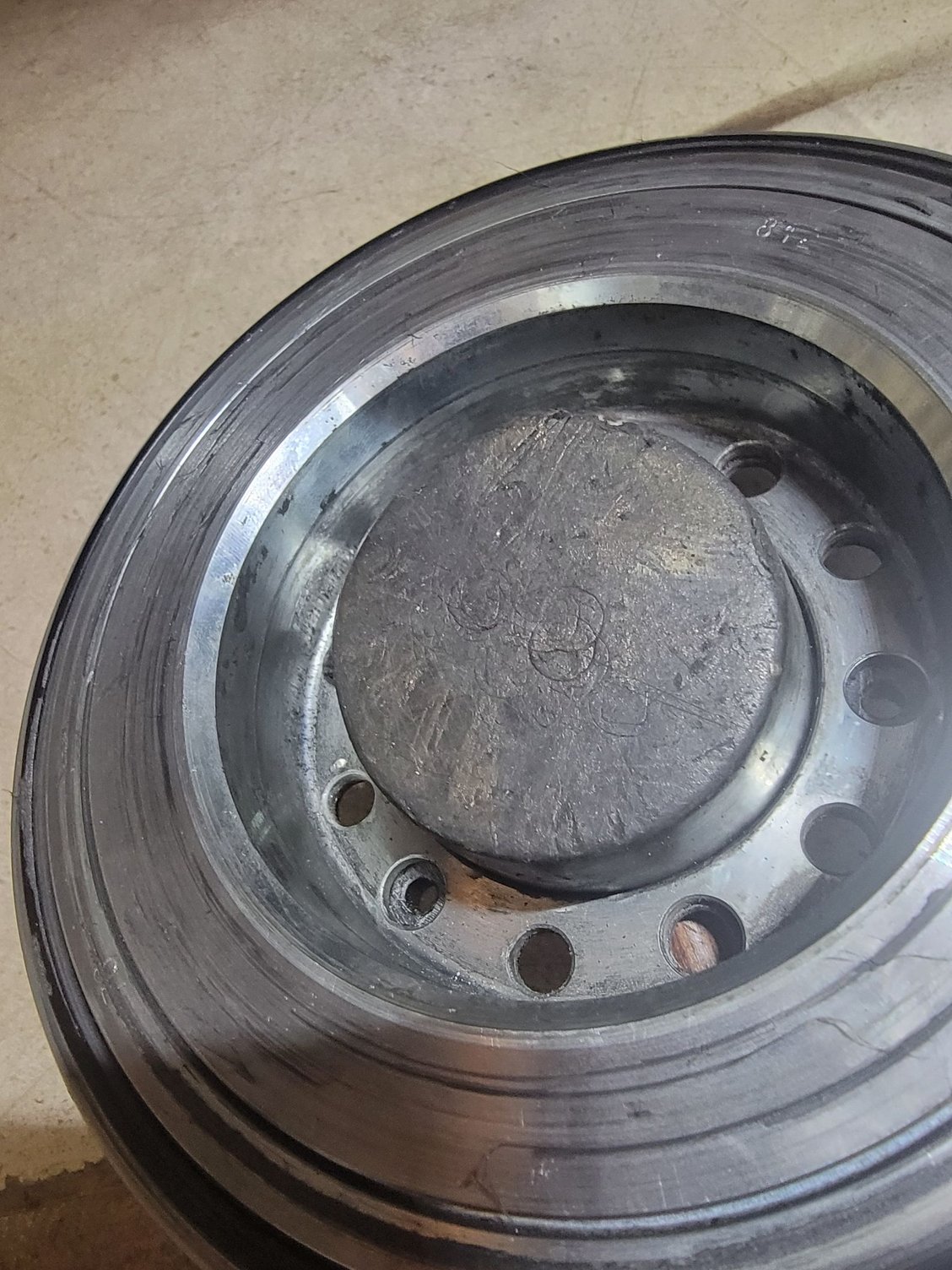

the interference is from this sidewall which rubs against the widest part of the gear. for some reason I have not seen any instruction to lubricate it

Thanks for the pic, I haven't seen anything online about any of that. I have however seen people use antiseize to help with this but some say it works some says its useless so idk. After looking at it again last nite now I see that part only has 9 holes for the screws and not the 3 extra for the puller. So now it makes total sense I jet need to find the right size screws. Mine will not fit 5/16 bolts that were supplied in the kit.
