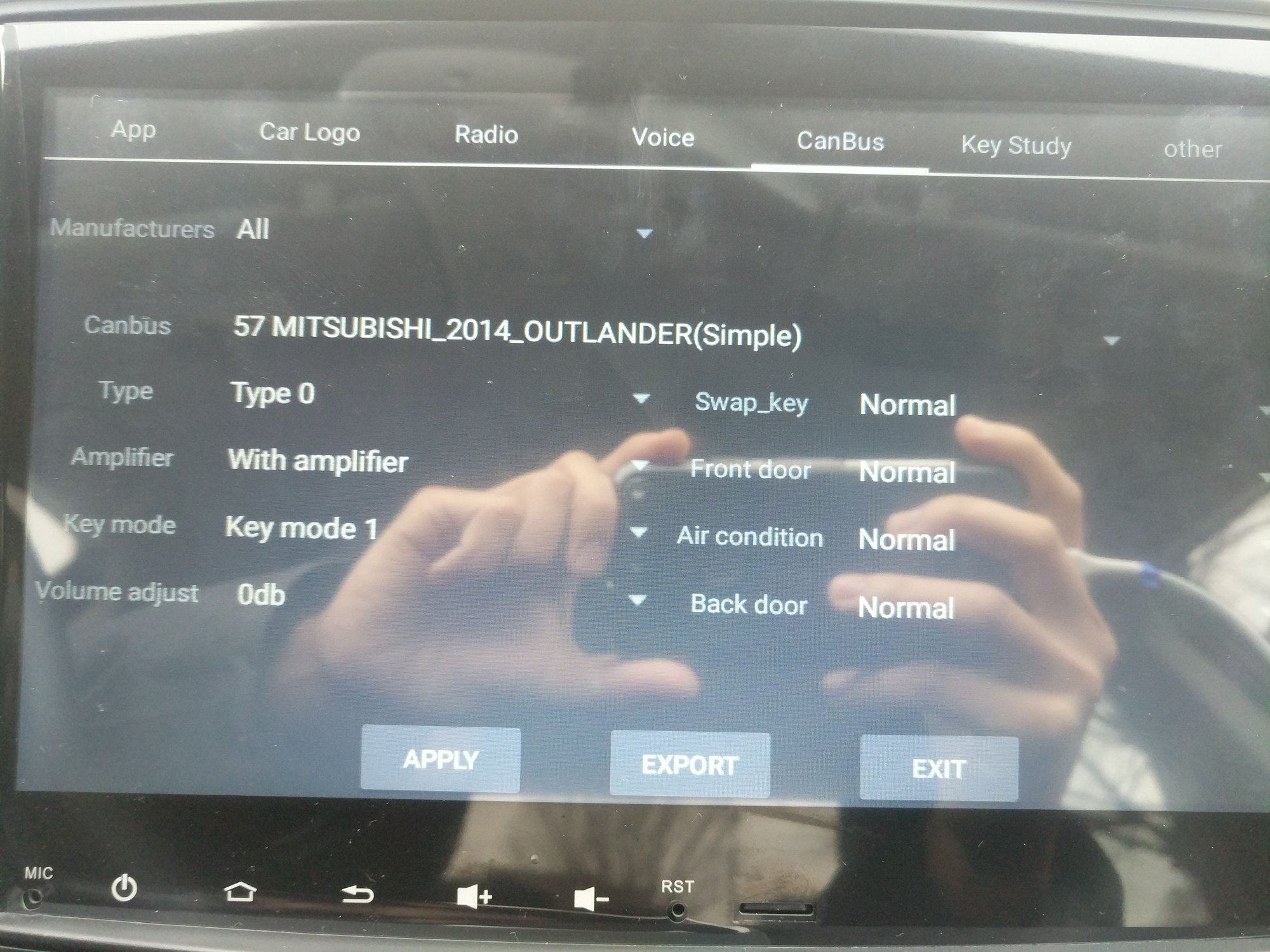

Take a picture of your cambus configuration, so i can compare. I also installed Viper4android, but that is another story. Download poweramp and configure it see if it works better.

Here is my can bus config.

how come my canbus setting looks different?
also, I'm only getting sound from the fronts only...
and my system version seems to be newer??
it says MTCD_HH

What headunit did you get? What model year car and did it come with rockford fosgate (RF) sound system?
Also, my MCU version is like December 14 2016. I can share that link in a bit but since I received from SYGAV, Id only recommend upgrading if you have same brand.
EDIT: Update on my own issues. After reaching out to SYGAV and doing some simple troubleshooting and sending photos back and forth, they have told me that they've sent the wrong canbus therefore they are sending another asap. Will update on my own once I get the new canbus installed.

My issue has been corrected after the firmware update provided by SYGAV.
tried to update using usb drive and gave error. make sure you use the sd card for firmware update!
