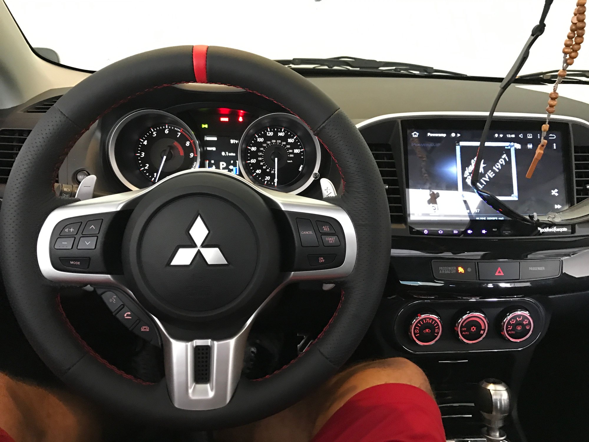

Like Steve say i dont think is too large, considering the tesla have a 17 inch one LOL. A 10 is realy good, as for the volume that is so 1970 jaja just kidding. Here is a picture of mine today.

Is it me or does your steering wheel look pretty thick? Is that an aftermarket cover or an MR trim thing? Looks really cool and comfy.

Is a Dallas Custom Steering Wheel, 1/8 Padding. I hated the stock one so upgrade it to this one. With Red Stitching and leather.
