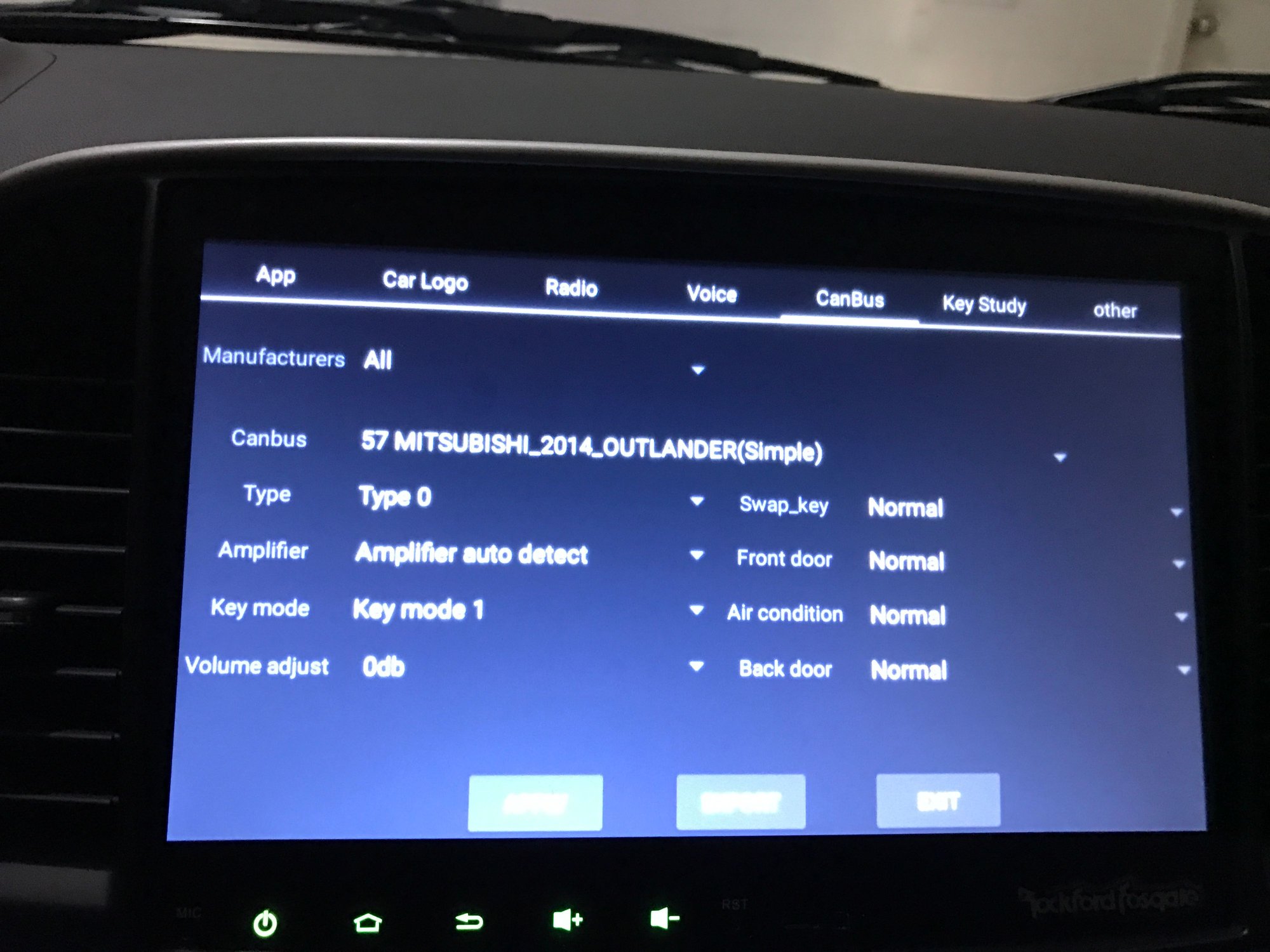

Here is my canbus and other pics glad to hear you fogure out the problem.

From: Tampa
Not newer but is a different firmware, from who did you got your unit? I will see if i can find your firmware update

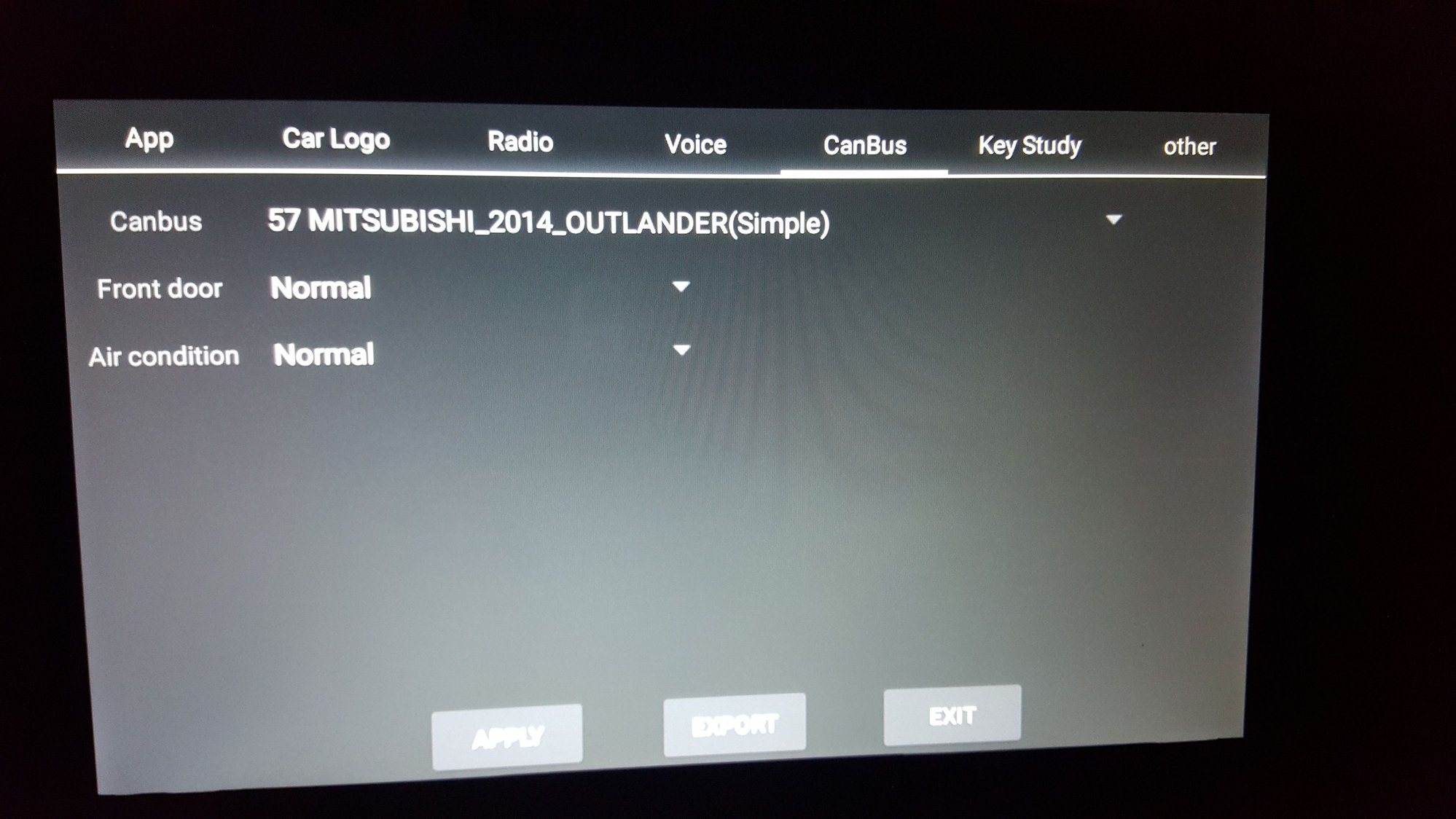

Originally Posted by Eunsangie
how come my canbus setting looks different?
also, I'm only getting sound from the fronts only...
and my system version seems to be newer??
it says MTCD_HH
