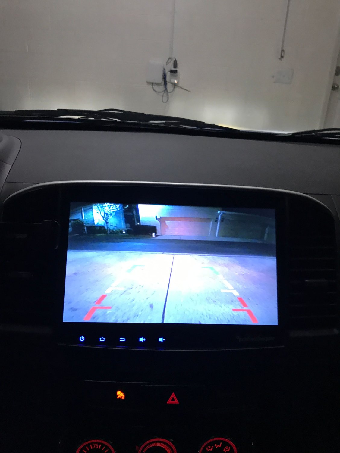

Do you mind taking a picture of the reverse cam video feed?
Maybe I need to change my camera to something better...
I'm slightly OCD when it comes to things like this for no reason lol.
Plus, I'm use to looking at MB C63 screen with super high def screen and my camera quality looks like a potato.
Originally Posted by NinjaX
I got the one they have i ebay on the add ons for the unit and looks great, again is just a backup camera at the end.

Here are some, keep in mind that i have a screen protector.
