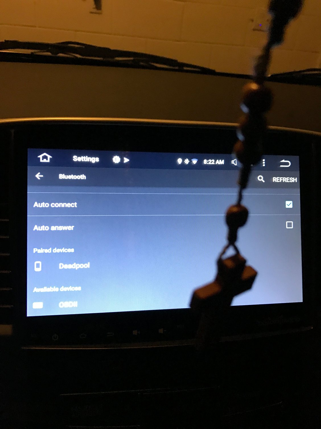

So the head unit sees the Bluetooth device. It just can't seem to pair to it.
Please see photo for version.

Update to the december one if you can.
also on the settings enter 126 there is a Bluetooth section, there are 2 modules there try the other one if the first one is acting up. I posted the update a few post ago.

Upgraded the OS. Definitely connects now but no dice in getting the app to read it. Will fully test everything tomorrow

There are some Bluetooth OBD2 adapters that just don't work with Torque. After the update my cheap $10 one is working (Foseal). It might just be hit or miss with which one you have.
I Just did the update as well - and now it's finally connected, not just paired, with the OBD2. For some reason, the Torque app still shows "Bluetooth not enabled" in the adapter settings, but it is connected and reading from the ECU. I guess the update is all I needed.
