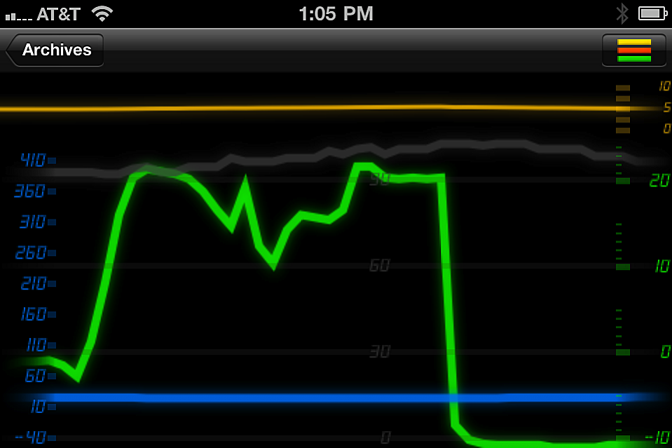

I did some pull and with some data log
please delete img if violate forum rules.

got that map in and went on a test drive. I still didn't hit 27psi, it's still at 22psi max. What is the boost target for each gear anyway. The 22psi is on 5th gear. btw, what is the different between ACN map and the regular one?
if you have newer map, please post up. I'd like to try. currently I'm not happy with map. it doesn't feel like driving a 290whp car at all.
Old Aug 27, 2011 | 08:06 PM
26-27psi +/- 3 psi is in 4th @ 3000
have you done a pull from 2000 in 4th?

No I didn't pull from 2000 in 4th. I'll try again when I have a chance. The data I exported to csv shows max boost is at 21.5. I'll keep the map and let you know how that goes in few days
