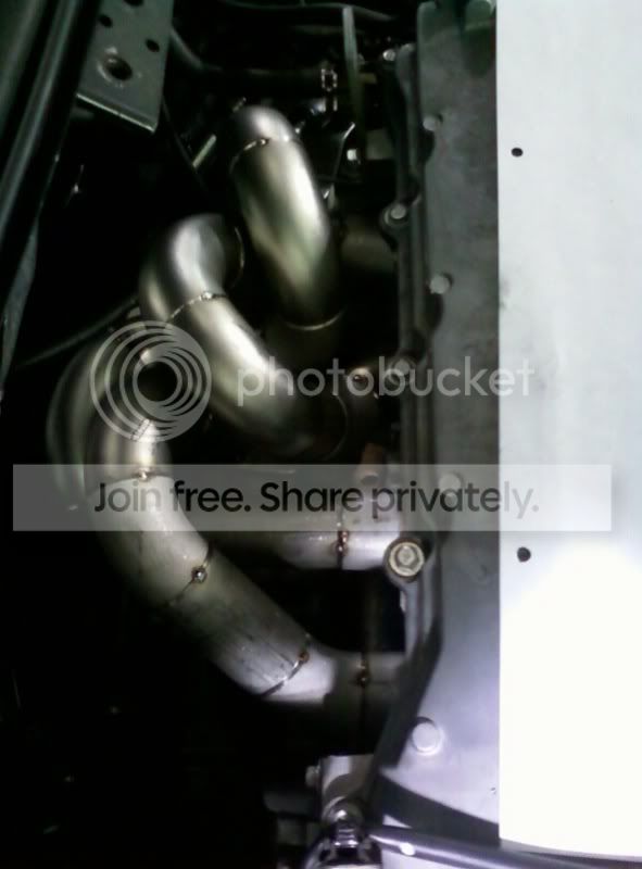

a little addition to the BBX on our shop car
more pics to come!
cb
