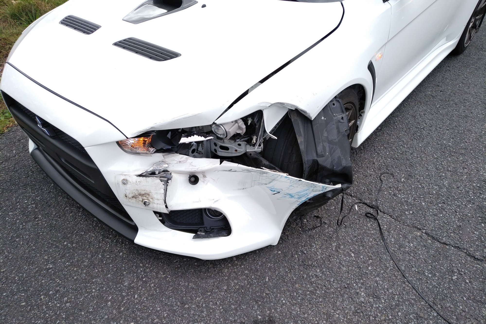

Well....this happened today, thanks to a crazy old lady. So looks like the build plans are on pause either way, until this gets sorted out. Big disappointment
Old Sep 23, 2021 | 03:06 PM
Jaraxle's Avatar
Joined: Mar 2012
Posts: 1,185
Likes: 261
From: New York
You gotta take your Evo to the shop that used to be called Elmo's in Scotia. They've done a lot of work on my Evo, and I told them ahead of time that I want it show car ready, not soccer mom 30 ft away my minivan looks the same standard. They did fantastic, and only one time I could feel some tape lines and I pointed it out to them and they corrected it.
I actually work at a dealer, and we have a place that all our work gets sent out to. But what you said is exactly my concern. My car has 40k on it and the engine bay is cleeeean. It looks like the some of the supports (radiator) will have to be pulled out, and I want it to look as good under the hood when they're done, as the outside does. Im gonna check that place out for sure and go talk to them. Thanks for the suggestion.
