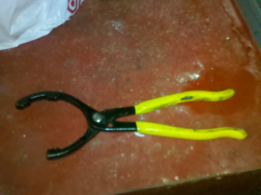

Take a look at the attached oil filter wrench. Worked like a charm. Plenty of space to get it in there. Plenty of leverage to undo the "amazing feat of strength" demonstrated by the factory/dealer in installing the filter in the first place. I've seen these at just about every auto parts store, Walmart, etc., and they are an inexpensive "one-size-fits-(almost)-all" tool.

I had to use the above "vice grip" style filter wrench as well. 3 trips total to Oreilly's. Anyone reading this don't bother with anything less. Also, the filter is the smaller filter, so get the "small" 2-3.5 inch range wrench like the one pictured above. Now that I have done it once, I will never pay to have it done again.
