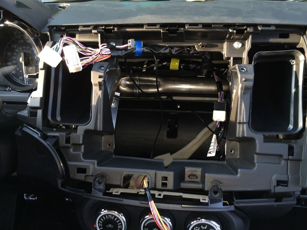

Hello, my car (2014 Evo X GSR) has only a couple of months and 1000 miles but since day one it has so many rattles and vibrations! it drives me crazy!, but there is a particular vibration that I hate the most, in neutral or any gear when I get to 2k rpm I get a vibration behind the AC controls. I've pulled apart almost the entire dash and discovered the cause but I don't know how to fix it, the vibration comes from this white box
Any help please? the vibration only comes when I'm at 2k rpm, I know is not a luxury car but it has so many rattles!!
I have the same vibration at 2k rpm in my new '15 GSR with 250 miles on it. It comes and goes though, really annoying.

So i have the same hvac rattle and found it's the plastic hvac to floor vent piece. it's the black plastic piece in the pictures. I can rev the car to 2krpm and press on this piece and it stops.
I put a screw through both pieces of plastic to better secure them but it didn't help. It's possible the actual rattle could be coming from the white plastic behind it.
