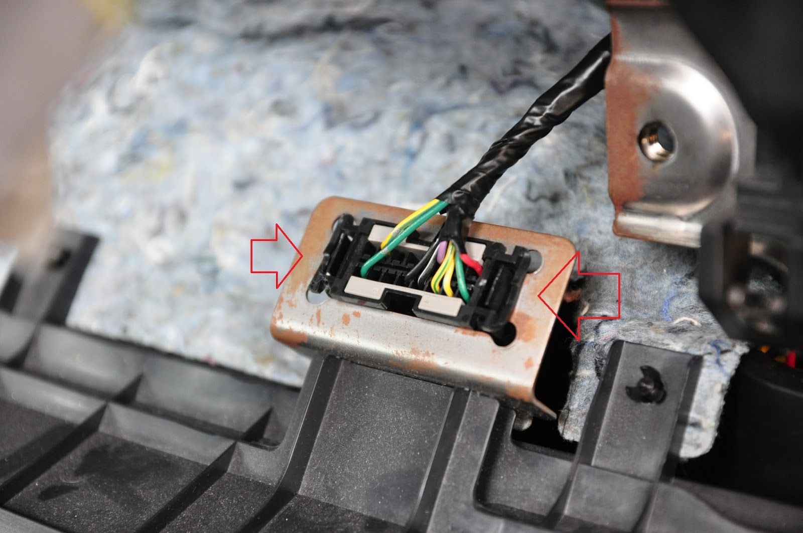

Un-clip the OBD2 connector both side. There clips that attach the lower cover part carpet. You can just use a flat head screw driver and remove it.
