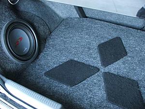

Another option
I have a custom pod in my trunk so it points from the side... just another way of doing it.
