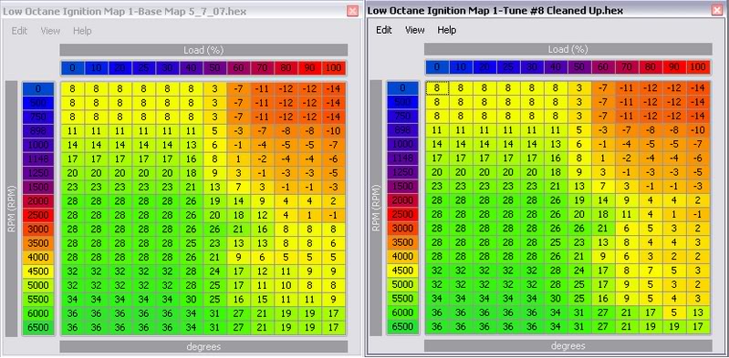

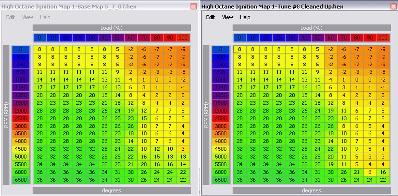

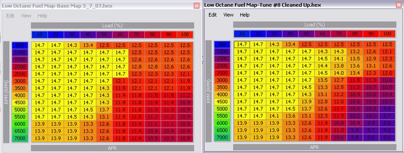

Those maps look pretty stock. Below are my maps from before and after my tuning session last night. Pretty big difference, eh?
High Octane - Before & After
Low Octane - Before & After
High Octane Timing - Before & After
Low Octane Timing - Before & After

Start out easy. I'm not sure about your setup, but I think something you're really going to need to watch is going to be your knock count. Right now, your timing is set pretty high (compare it to Zack's.) When I was driving and Zack tuning, we worked at bits of it at a time to start. First worked heaving on the 3000-5000 range, then the higher 5000-6000 range, then started doing minor tweaks in 500 increments until it was right. If yours is anything like what we ran into, you'll be really rich down low (2000-3000), then start to lean out and get some knocking up to around 4000-4500, then get lots of knock above that. While doing pulls, most of the tweaking was done in the 80-90 load range.
