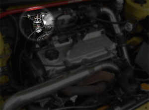

you are correct, the stock wrx injectors are 440, but i'm running NGK 450s.
the fmu is a variable fmu which i have set at approx. 30
here it is:
Old Jun 7, 2007 | 11:16 AM

Isn't that a universal fuel pressure regulator from Ebay?? Please tell m it isn't
