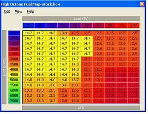

do all stock fuel maps have to look the same or can it have some variation?
Old Aug 7, 2007 | 02:08 PM
  #651
senate6268's Avatar
iTrader: (20)
Posts: 1,987
Likes: 19
From: Buffalo Grove, IL
I'm not sure if the FED and CAL spec have different maps loaded or if the maps had variations when the returnless fuel system came about in 2004. That's a good question.
Old Aug 7, 2007 | 02:30 PM
  #652
elcausa's Avatar
Joined: Jul 2007
Posts: 9
From: nj

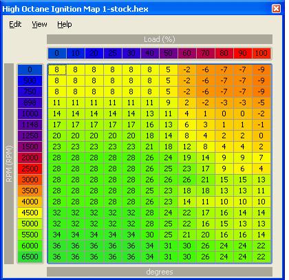

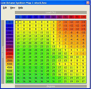

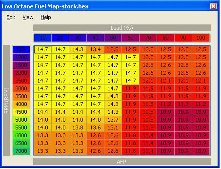

i was asking because there was no def file for my rom so i had to edit one def file for it to display properly, i was aiming to get it to look like the one in the first post, is the same for the most part just some cells have different values so i wanted to make sure i did it right
Old Aug 7, 2007 | 02:33 PM
  #653
senate6268's Avatar
iTrader: (20)
Posts: 1,987
Likes: 19
Post a screenshot of your high/low octane and high/low timing maps just to make sure before you start changing values.
Old Aug 7, 2007 | 03:06 PM
  #654
elcausa's Avatar
Joined: Jul 2007
Posts: 9
From: nj
here are the maps the id number is 81900016
Attached Thumbnails ***ECUFlash Now For Base Lancers!***-highoctane.jpg   ***ECUFlash Now For Base Lancers!***-ignition-high.jpg   ***ECUFlash Now For Base Lancers!***-lowoctane.jpg   ***ECUFlash Now For Base Lancers!***-lowignition.jpg
Old Aug 7, 2007 | 05:27 PM
  #655
senate6268's Avatar
iTrader: (20)
Posts: 1,987
Likes: 19
Those look right. Have fun!
