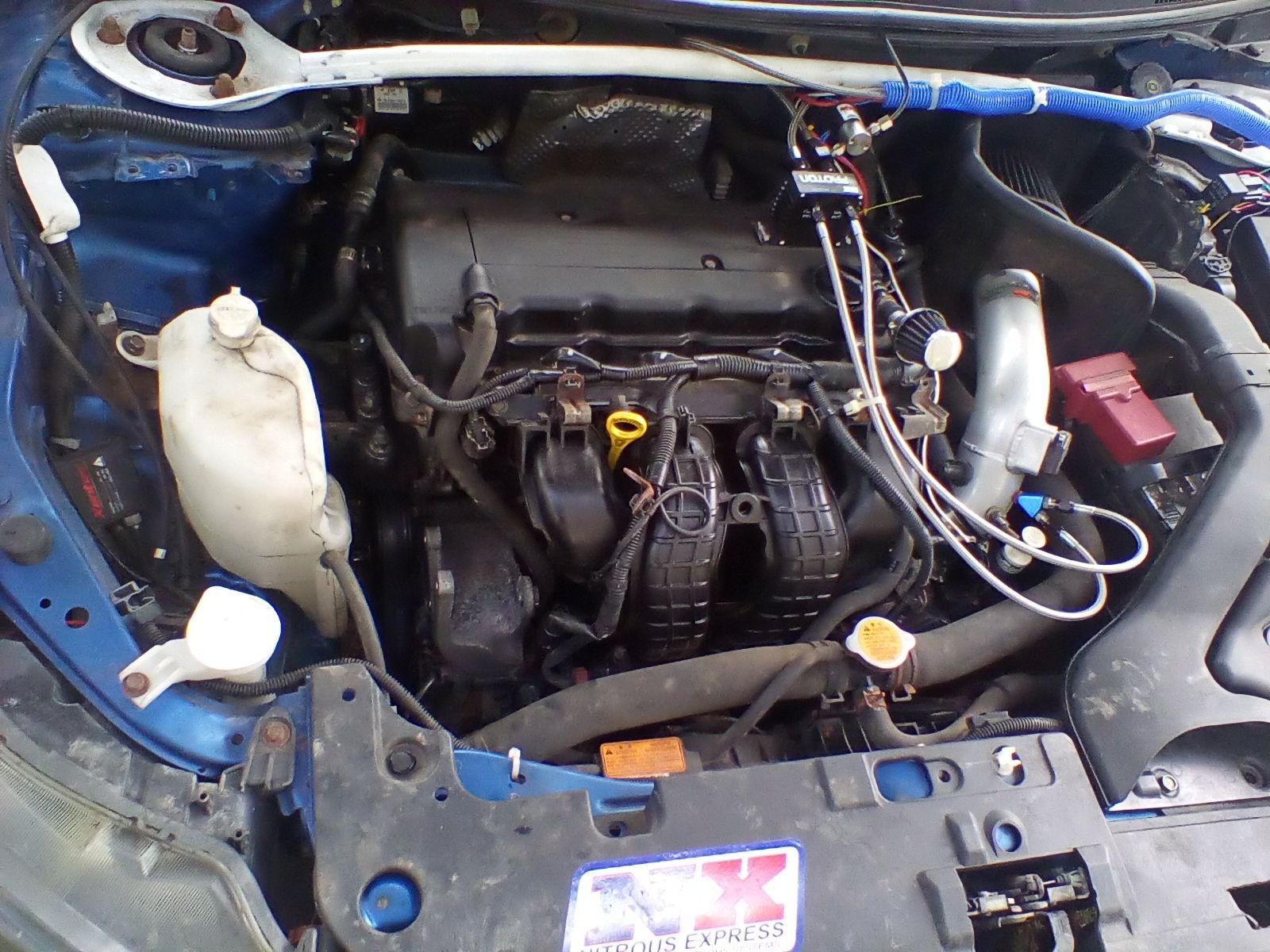

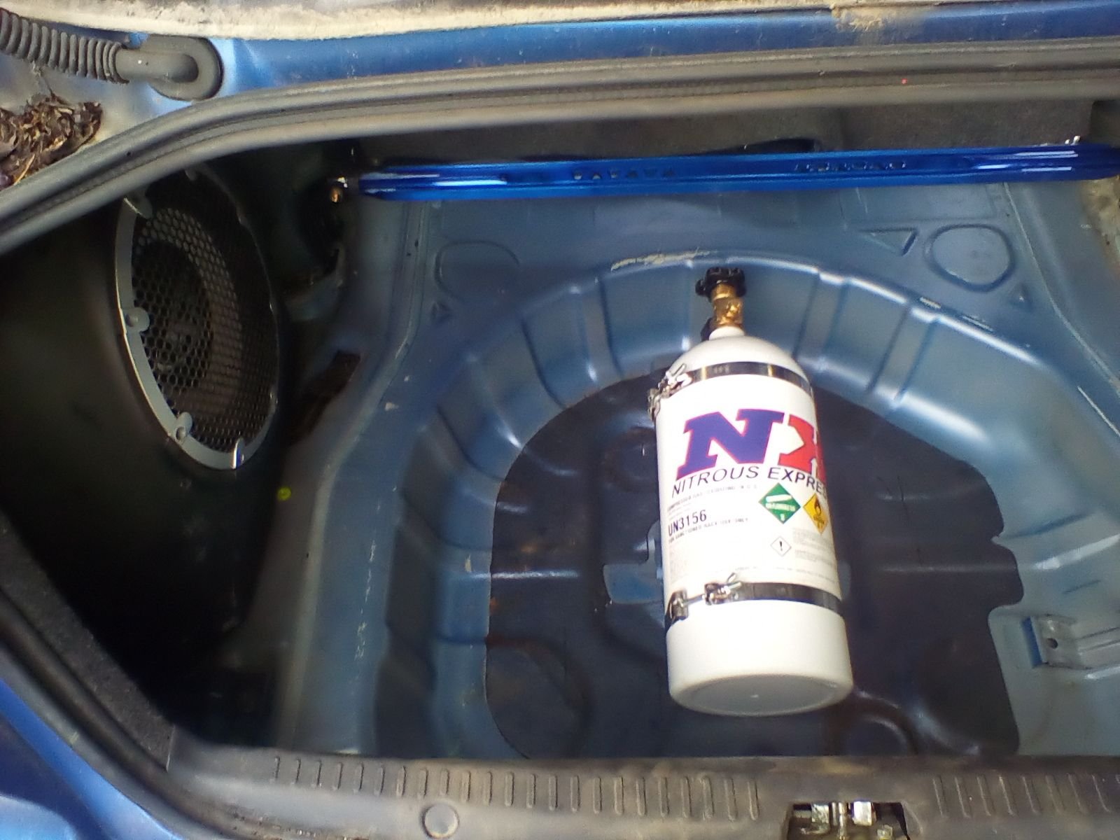

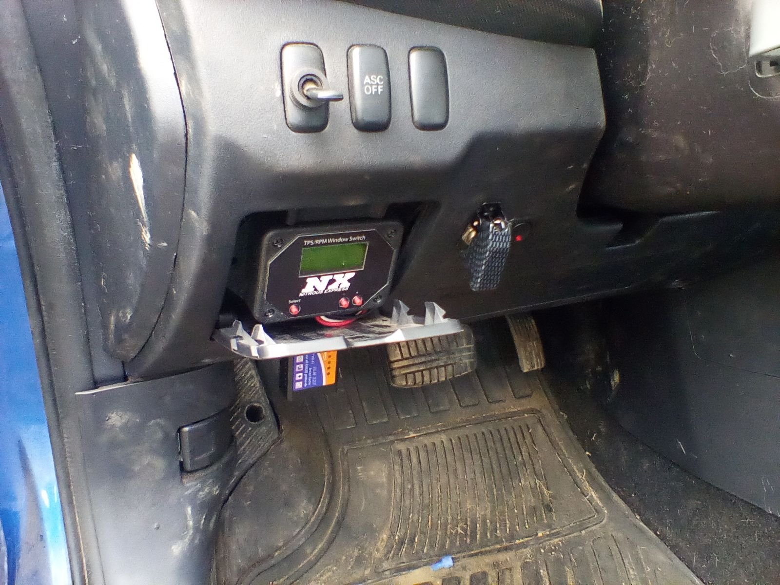

Sorry to dig up a old thread but going to the track hopefully Friday, but won't be spraying unless my rrm trans cooler comes delivery date was supposed to be last week but when I look it still hasn't shipped. I have a wet kit with nx controller only running 35 shot from 3500rpms to 5500 rpms starting in 2nd gear to 6. If the CVT seems to hold up with the larger trans cooler I may work up to a 50shot. But I know the CVT won't handle any higher than that
. I'll do some NA runs and a couple spraying and post the slips. Here is other mods to the car, Car has Evo x cams obx header full exhaust Mopar valve springs modern performance crank and water pump pulleys with ac and ps delete. 63mm TB ultimate racing solid motor mounts and full mivec tuning.
