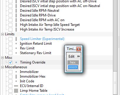

4g94t
Add this to your XML
<table name="Timing Override" address="1914a" type="1D" level="1" scaling="Hex16"/>
The default should be 0x2ab1
Override this with 0x9
I found this is one of the few places where i can see a set value overriding the timing in ram so lets give this a shot
Old Aug 19, 2010 | 06:36 PM
  #585
4g94T's Avatar
Posts: 2,069
From: California
Like this?
Attached Thumbnails Confirmed:  Evo ROM Can Be Flashed to Lancer ECU-untitled.jpg
