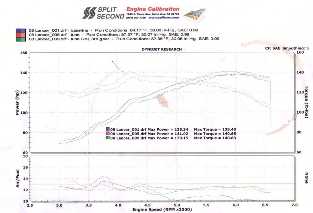

here is a dyno that we did on a 5spd federal lancer
blue - stock
red - piggy only
green - cai piggy
the cold air lost power that is why we didnt produce it.
i am wondering though on the cars with the Injen parts, i thought Injen posted a dyno say 9hp from the intake and 9hp from the exhaust?
so i mean that is close to 20h i didnt see that much gain.

niiiiccceee... I especially love the coffee cup stains on the sheet
