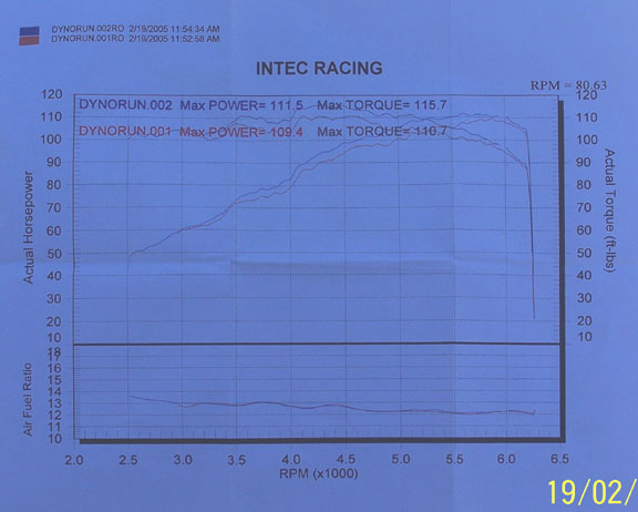

*******.... just got off a dynojet 248 and posted some crap numbers. Not sure what the problem is, but here's a pic (fawking snapfish )
3rd gear pulls made a whopping 111WHP and 115TQ
Guess that means the Auterra PDA dyno isn't that far off, huh Rhyzin

my guess is the head is ported too aggressively for the cam, or that I still need to bring more air in . . . . . not at all sure what's up

From: Hemet, CA
your torque curve looks great actually... i'd take out some of that fuel up top to pick up some torque and hp. Your still running a 12:1 ratio up high... usually i try to keep it closer to 13:1 on the NA application. Also i've been able to push about 8 degrees advance timing below 4k rpms... then do 6 at 4500... 4 at 5k to redline. All on a 13:1 ratio running 91 octane. When you get your cam set it up for 2 degrees advance with this tune on you emanage and you should be well over 125whp.
Maybe you can make the above changes and redyno. This info is what i've done with the emanage on the lancer already. It's not to aggressive but for 91 it's safe and sound. Good luck.
Is that basically your bolt-ons? If so, it's looks kinda right, but it's a bit on the low side. If it's w/ cam work, it isn't right.
Maybe, you need to dyno it again via Auterra PDA. At least try to eliminate the possibilty of driver error on the pull. Then again, 3rd gear isn't exactly 1:1 (gear ratio), and I know it's hard to find enough room to pull 4th gear.

Since I've been tinkering, I thought I'd add a couple notes to my previous posts.
First, that dyno was before cam or timing work, so that wasn't the issue.
Second, exhaust leaks suck. however, thread lock is our friend and once that leak between the header and dp was fixed, it was like night and day.... I wish I'd taken care of that before.
Also, that wasn't with "bolt ons" exactly. I'd like to argue that a ported intake manifold, ported head and eManage running the 16X16 fuel map is a little more advanced than just bolt ons. Or you could argue that every modification to the car is just unbolting something to bolt something else on, so it's all bolt on mods
