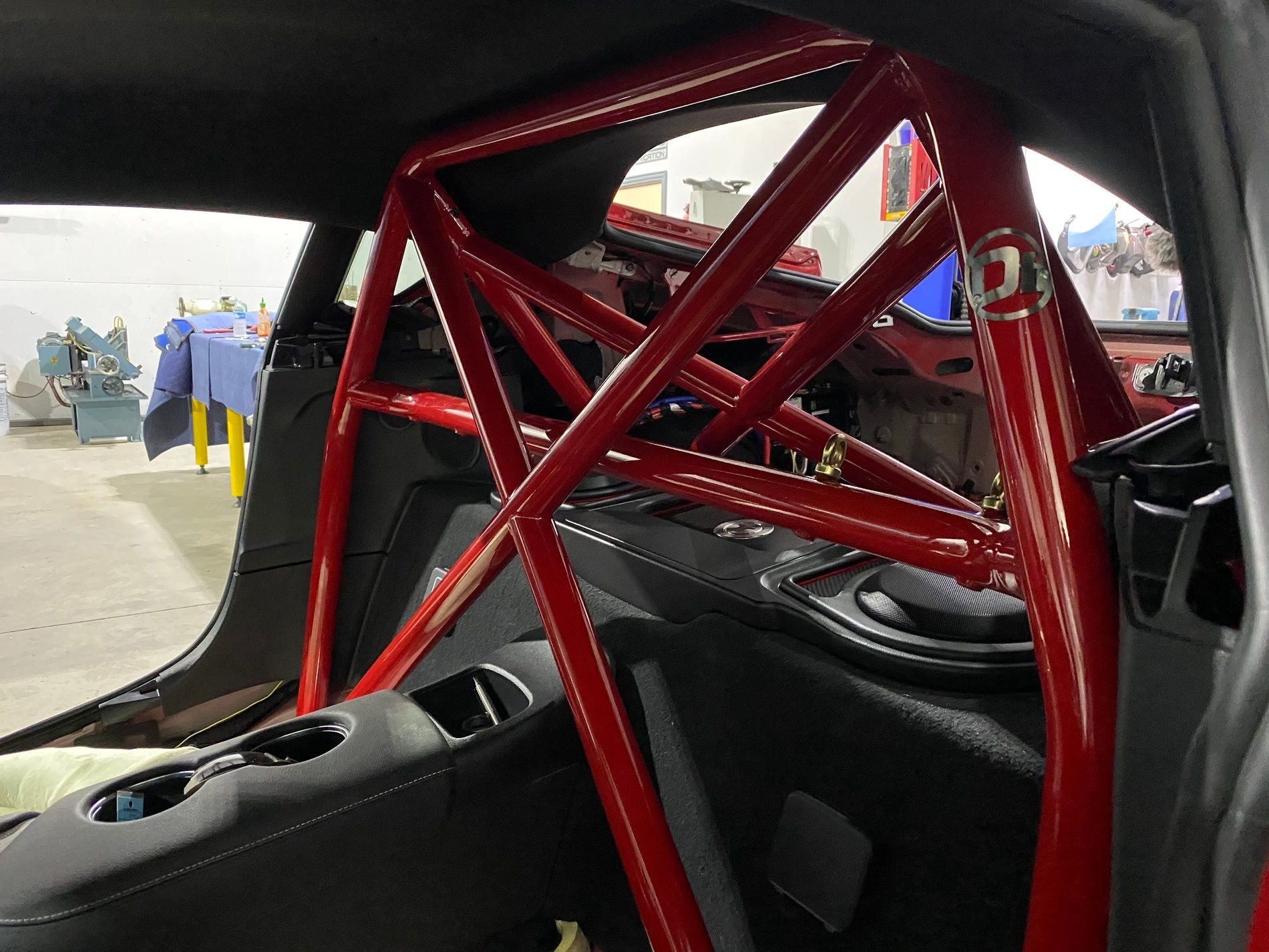

Looks like you have gone for wrap around harness option rather than screw in eyelets.
Looks like you had the harness bar lowered a bit.
Yes and yes. I also had the horizontal bar go straight across and intersect the diagonal instead of bending back and going behind it.
Here is another photo of how he usually does them to compare to mine.
Mine and the one above are based on his "GP Lite"
Here is his "normal" bar. I didn't want all the extra tubing and the extra 20lbs! it adds.

Looks like yours is bare metal rather than painted.
Do I win?
How is the chassis thickness where this attaches? Plenty of material to attach to?

That jungle gym is nuts. Seems weird to have a rally worthy roll bar without the rest of the cage.

At least this roll bar is probably putting the harnesses in the correct position for his seat.
