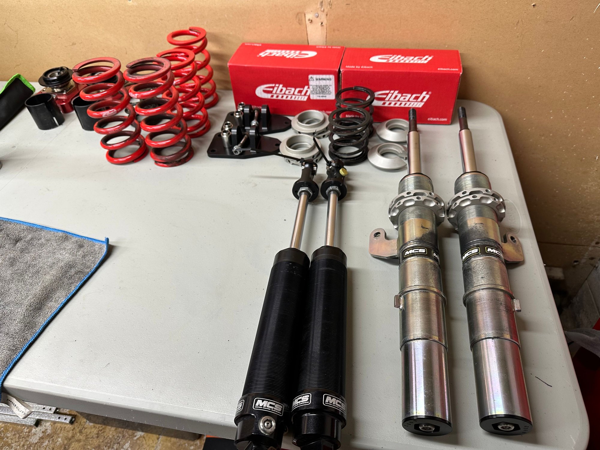

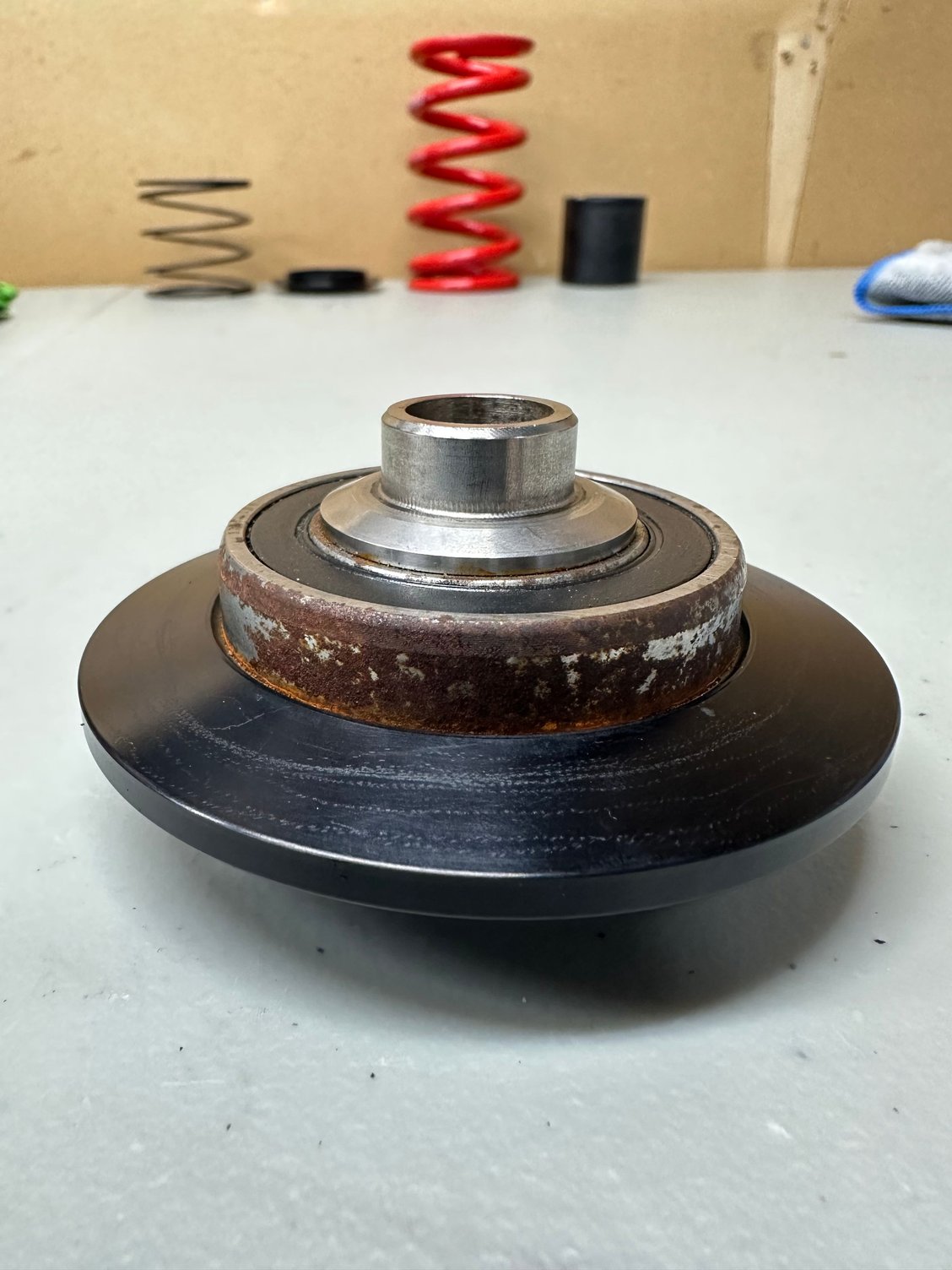

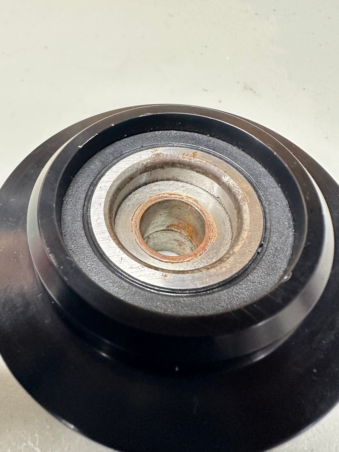

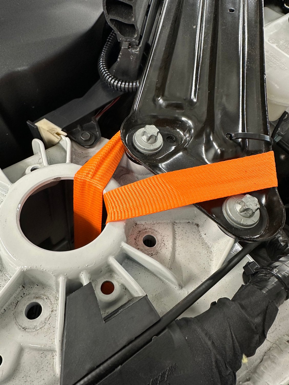

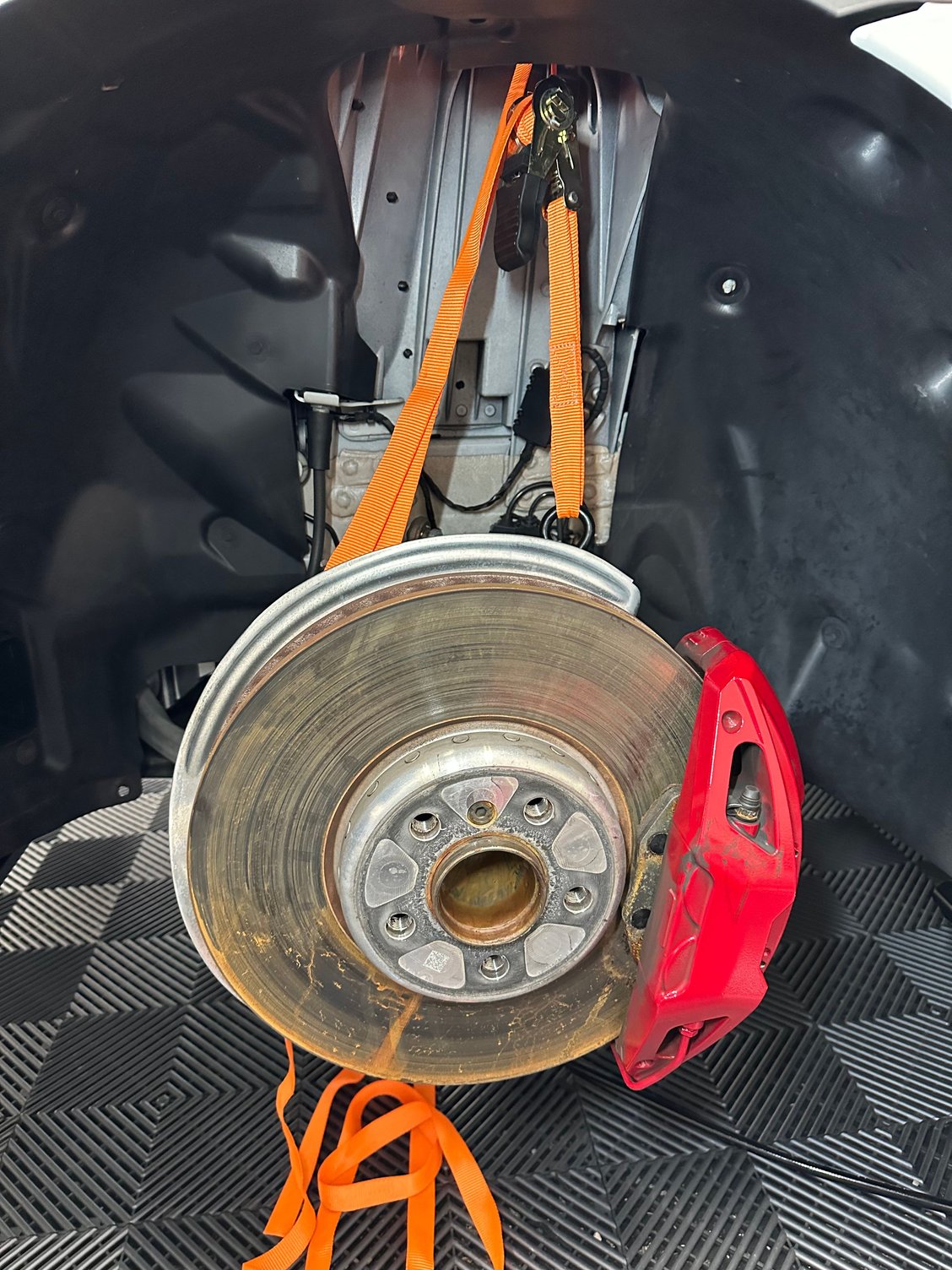

Taking my MCS coil overs off to send in for service since I was a dumbass and broke the adjusters at the beginning of last season.
Had to figure out a way to take stress off the suspension arms with nothing to hold the hubs, I got creative…
Also, vorshlag camber plate bearings are… meh

Is that just from moisture getting up in there? I'm assuming since the car doesnt see winter you're not worried about salt corrosion...
BTW how are your daily cars fairing out there with the road salt, etc.? Just curious...

Coilovers all disassembled and ready to send out for service

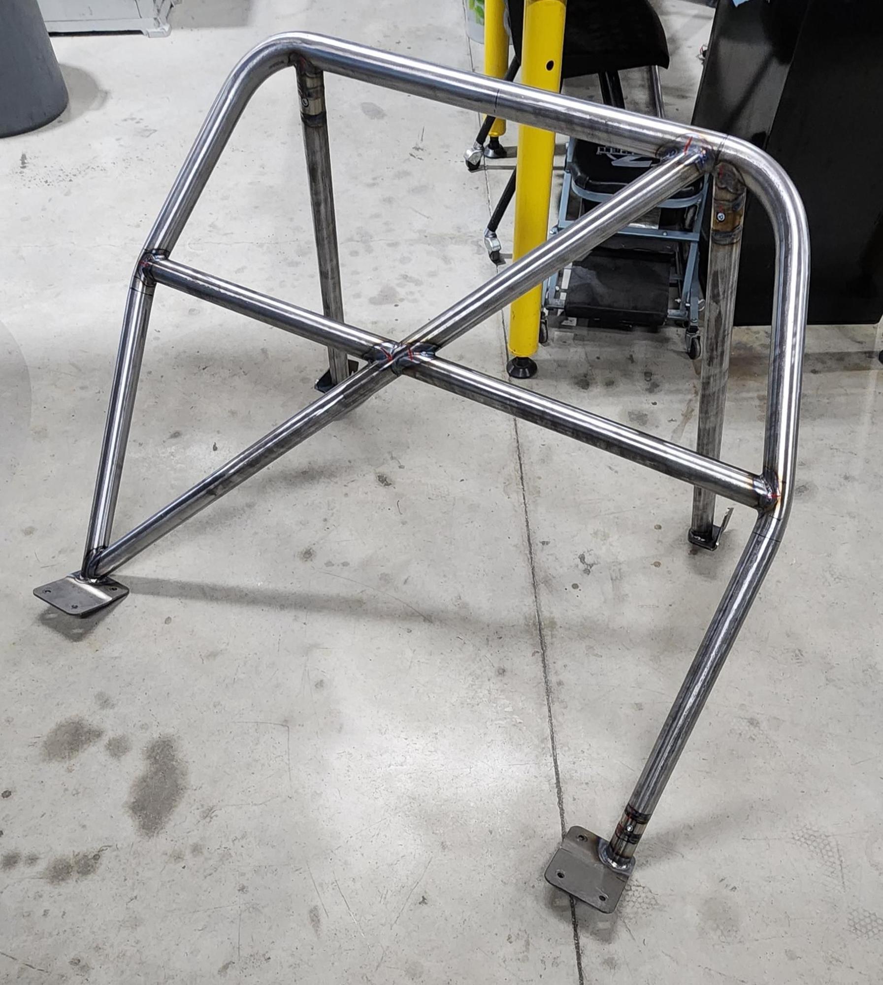

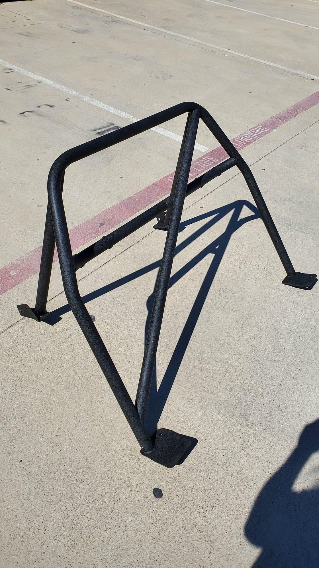

Dashbuilt. This one is slightly custom per my requests. They are usually built like the below photo. See if you can spot the differences
A lot of the current offerings are very much show items. One of the more popular options use rivnuts to attach to the chassis and only one bolt on two of the plates. Yea, no thanks. hard pass.

Looks like you have gone for wrap around harness option rather than screw in eyelets.

Looks like you had the harness bar lowered a bit.
