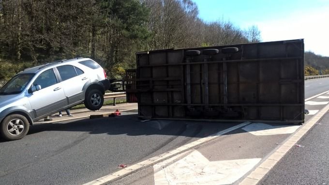

There's a clip that goes around the bottom of the ball, you lock it in place with the safety pin. Then you have the two safety chains. And the disconnect emergency brakes. It'll literally try to kill you before it comes off of there lol.
That's comforting...but not.
A lot of things had to go wrong to get to that point. If its setup right, you'll be hard pressed to ever get there even in an emergency. If it feels sketchy just driving around bends, you need to adjust something.
